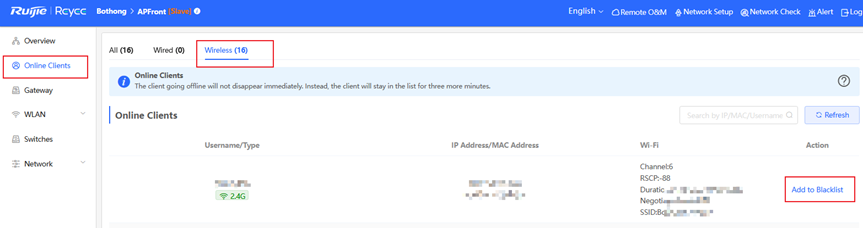

How to kick-off client for Reyee AP? Reply
4607 0 2023-8-9 13:18:09
When there are wireless clients connected to Reyee AP, you can only kick-off them by adding to blacklist on the eweb page of Reyee AP:
