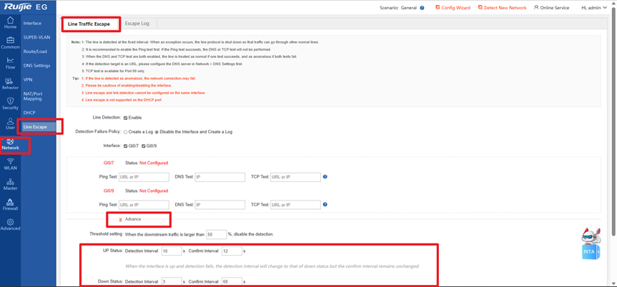

How to change Line escape detection Interval on Ruijie EG? Reply
3548 0 2023-8-9 16:58:28
You can click Network>Line escape>Line Traffic Escape>Advance
RG-EG3230
Configuration Router
