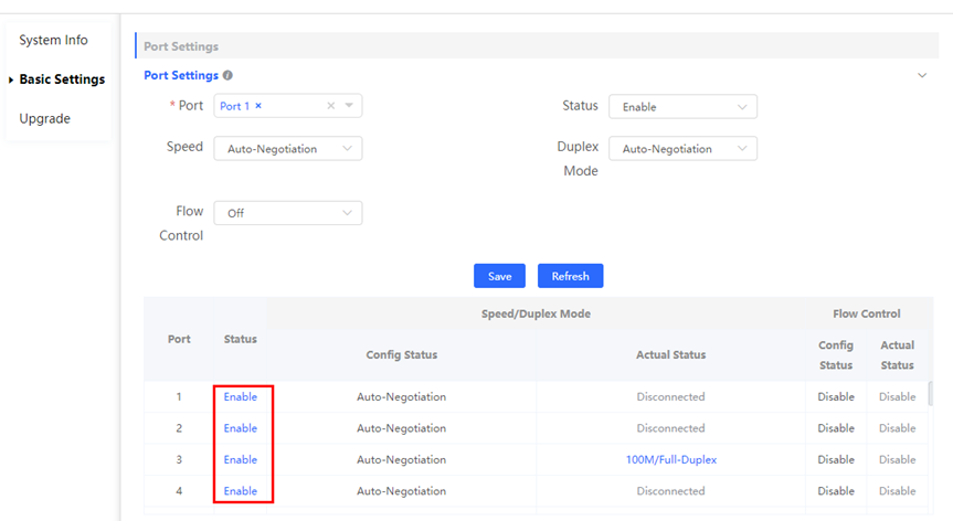

1. Check whether the PoE port is enabled

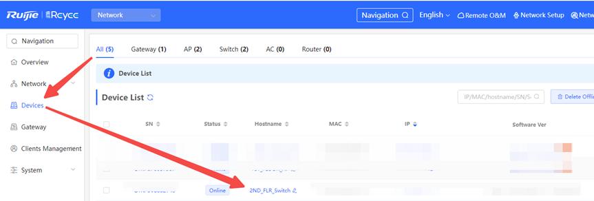

3. Check whether the adapter that supplies power to the switch is damaged, switch another adapter for the switch
4. reset the device
5. Check whether it is the latest version of the firmware, if not upgrade to the newest for the switch.
