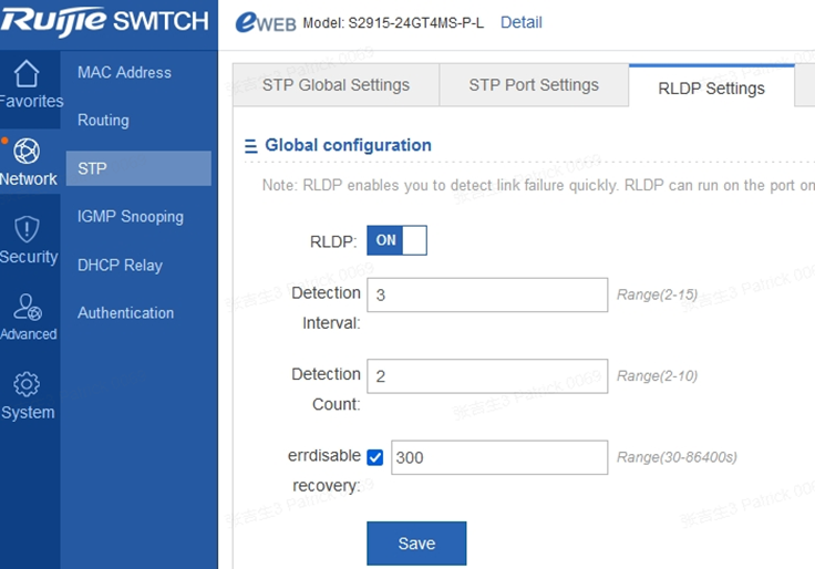

1. Please check if RLDP is enabled or not correctly on Ruijie Switch.

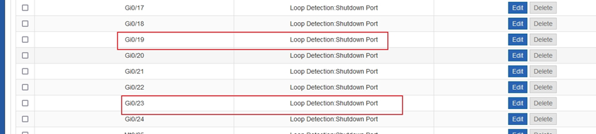

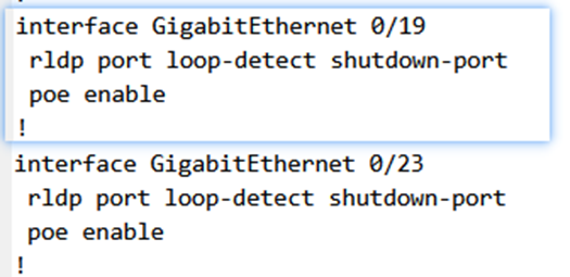

2. log in to the CLI of Ruijie Switch via console or telnet, and check the loop port setting by using this command:
show rldp interface GigabitEthernet 0/19
show rldp interface GigabitEthernet 0/23

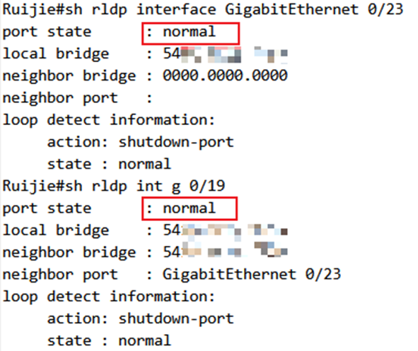

3. Check the RLDP status of the loop switchports by using this command:

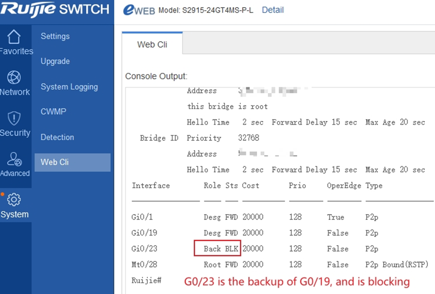

4. If you connect a loop, but the status you got in the previous step shows normal. Then please check if you configure STP/RSTP/MSTP on your Ruijie Switch or not.
If there is a port blocked by STP, please turn off the STP function and test RLDP again.
You can type this command to verify the STP status: show spanning-tree summary

③ Assume that Ruijie Switch has enabled the STP already. Please be minded that STP and RLDP can't work together. Because there is a loop that occurs on Ruijie Switch, STP will first detect the existence of the loop and BLOCK one of the ports. At this time RLDP does not consider that a loop has occurred.
