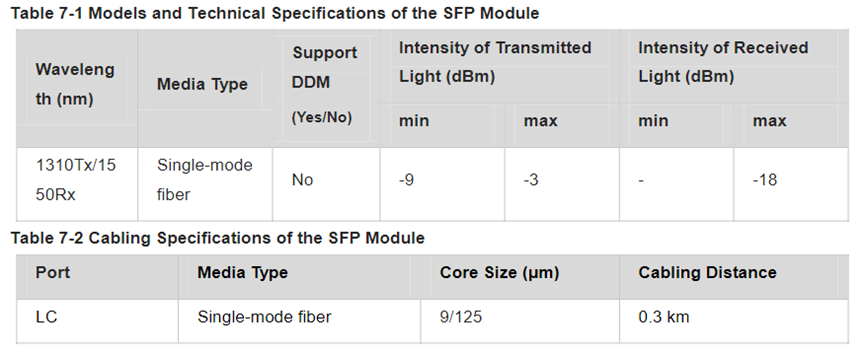

What is the spec of the SFP module that is supported by RG-AP820-L(V3)? Reply
3230 0 2023-8-10 09:43:24
The spec of the SFP module that is supported by RG-AP820-L(V3) is as follows:
For more details, you may check this hardware guide, page 37:
https://www.ruijienetworks.com/resources/preview/77234/
