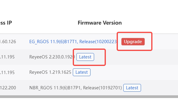

if it shows like "latest" in this picture, then it is the newest version ;
on the other hand, if ti show "upgrade" like in the picture below ,you need to press the firmware on the left side to upgrade;

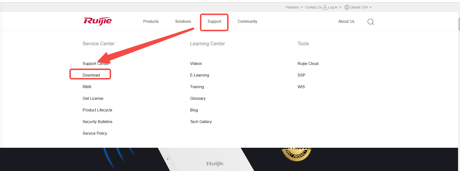

if the old three have the latest version, you can download the latest firmware by serching the new router's model name in the download page below on our official website and log in to the WEB of the new router ,(1.Connect to the default wireless SSID “@Ruijie-sXXXX”.2.Log in to the device by using the default management address 192.168.110.1)
then upgrade it locally on the web:
And I want to confirm with you that what is the model of your new router? is it belongs to EW series, is it the same model as the old three?
