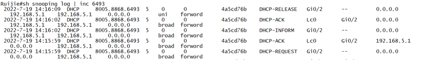

2) if snooping is configured, you can use this command to check: show snooping log | inc APmac+1

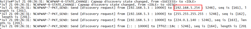

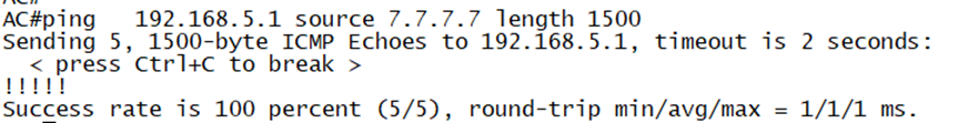

4.        Ping AP address with length 1500, source AC tunnel address(option 138 address)
AC#ping 192.168.5.1 source x.x.x.x length 1500
Notice: The default tunnel address of ac is loopback 0. If "capwap ctrl-ip xxxx" is configured under "ac-controller", the latter address is used as the tunnel address
1) if ping succeeds but ping with length 1500 fails:
You need to check the MTU of the intermediate device
If the MTU cannot be changed on the intermediate device, you can check how many bytes can be pinged from the AC to AP can succeed and change the value on AC:

3) if ping with length 1500 can succeed:

(Check whether the AP sends a capwap discover packet to the AC address)

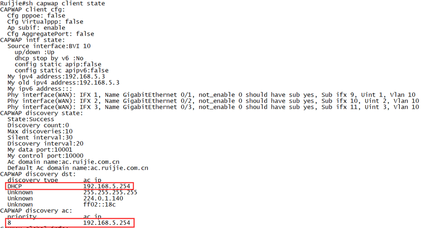

show capwap client status
show ip f f | inc apipadd
(Check AP ip address and whether port 5246 have information)
