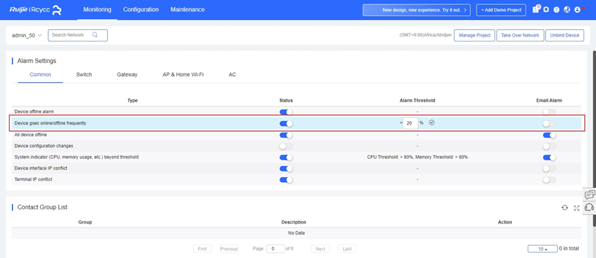

Configure Alarm Threshold for Device goes online/offline frequently. Here is the reference example:
1.        2 hours is 120 minutes.

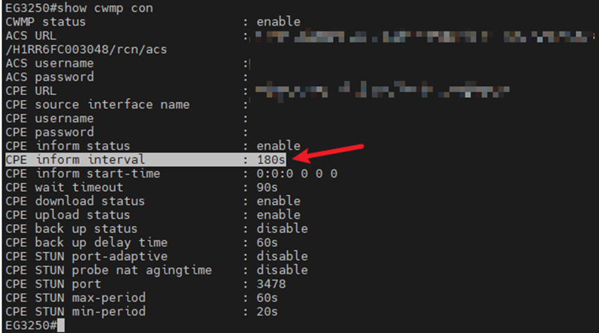

2.        devices inform time will take 3 minutes to be connected to cloud.
120/3 =40, means the maximum number of times devices can online/offlie is 40.
40 x 20%=8.  Means alarm is generated if the online connection exceeds 8 times.
If more than 8 times are online/offline within 2 hours, an alarm email will be sent.
