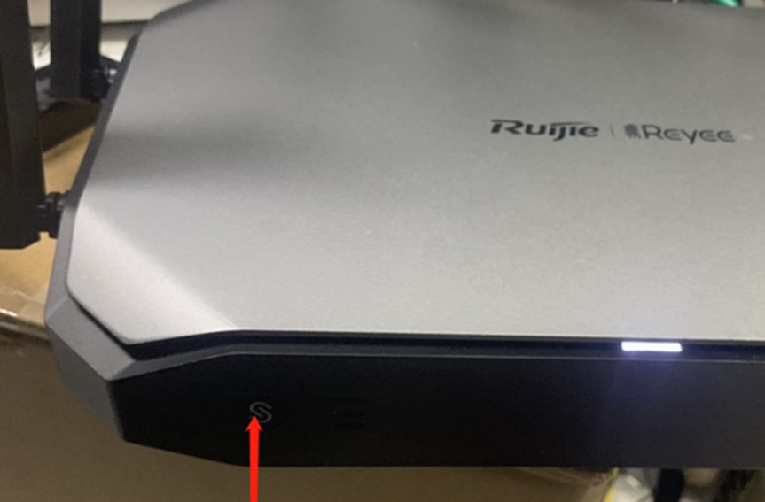

Can I use the mesh button of EG105GW(T) to mesh with Reyee AP? Reply
4098 0 2023-8-10 13:55:31
Edited by GTAC-Bancroft at 2023-8-10 13:57
Yes. The mesh button of EG105GW(T) can work with Reyee AP if you want to do Reyee AP mesh between them.
Please be aware of the following information:
1. The Reyee AP should support AP mesh as well.
2. Only EG105GW-X and EG105GW(T) support one-button pairing of Reyee AP, and pairing with up to 15 Reyee APs.
3. EGW has already enabled SON and completed the network initial setup.
4. Reyee AP to be paired has been restored to factory settings and is fully powered up.
5. The distance between EGW and Reyee AP needs to be less than 2 meters.
