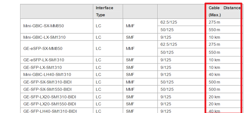

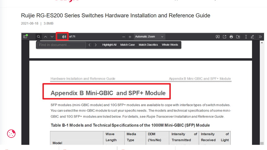

This is determined by the type of SFP module. You can refer to this link: Ruijie RG-ES200 Series Switches Hardware Installation and Reference Guide
