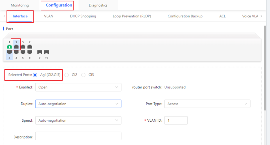

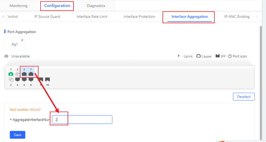

2.        How to configure on Cloud?

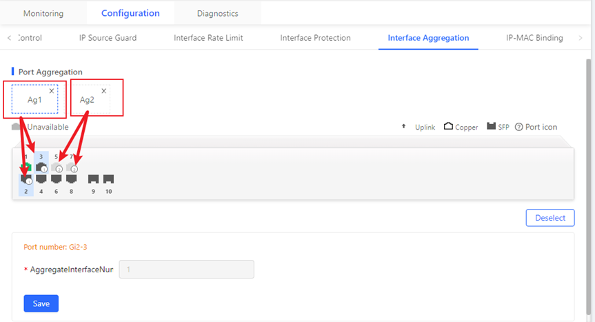

verification:

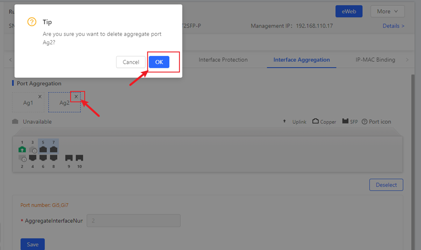

How to delete:

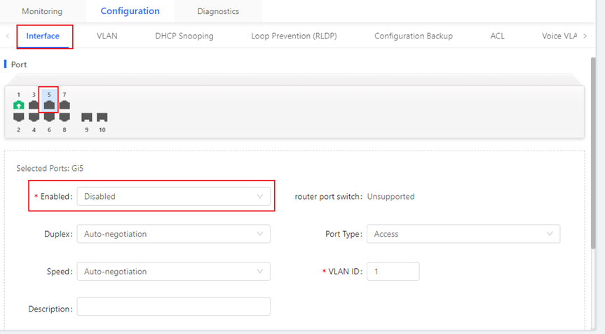

Notice:
After deleting the aggregation port, the physical port will down, need to enable it manually.
