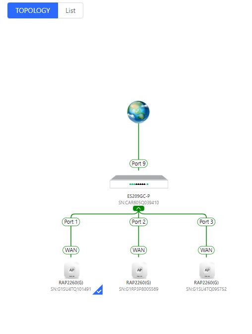

I have four Ruijie access points (RAP2260(G)) devices connected to a single Ruijie (ES209GC-P) switch. All four devices have the same password and name. I want to know how to change the name and password of one device only, while keeping the password and name of the other three devices the same.

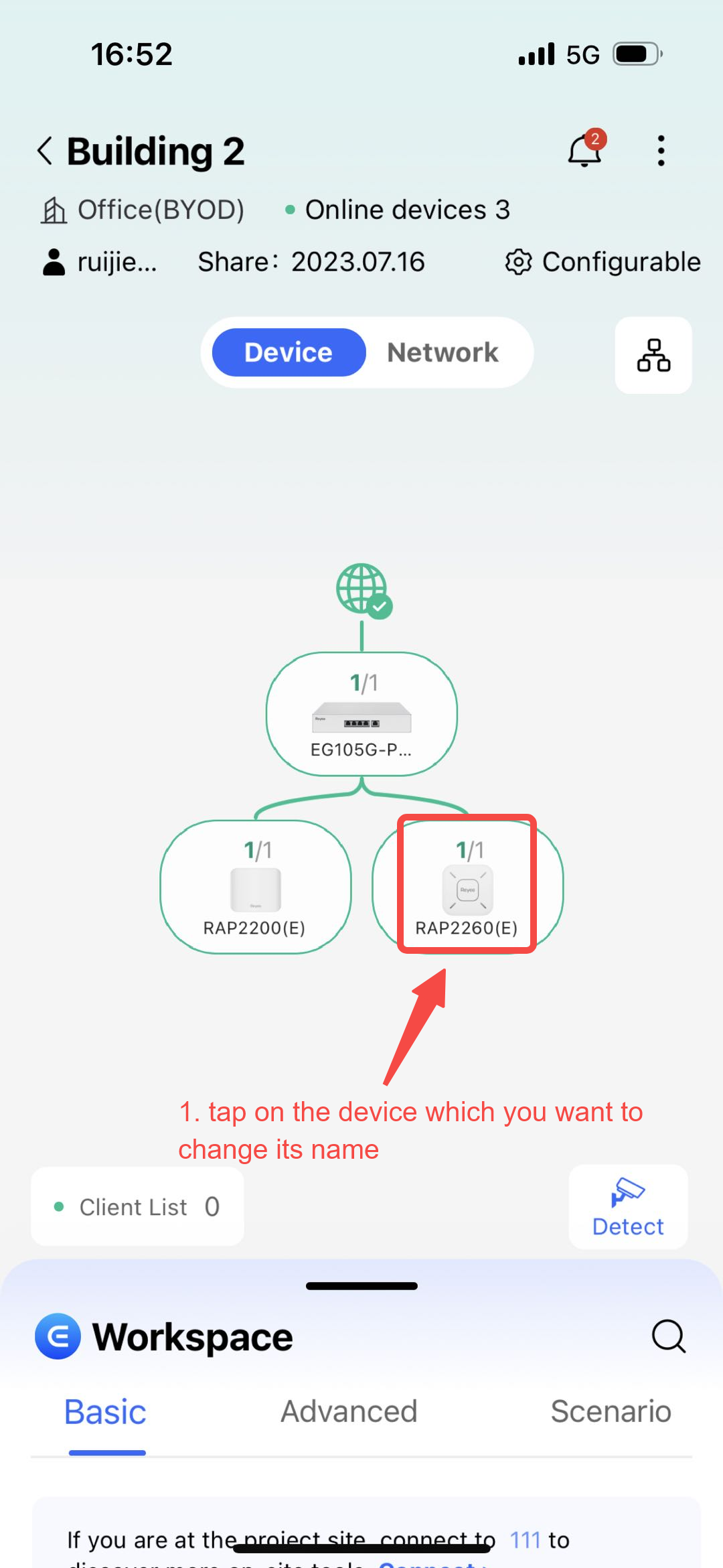

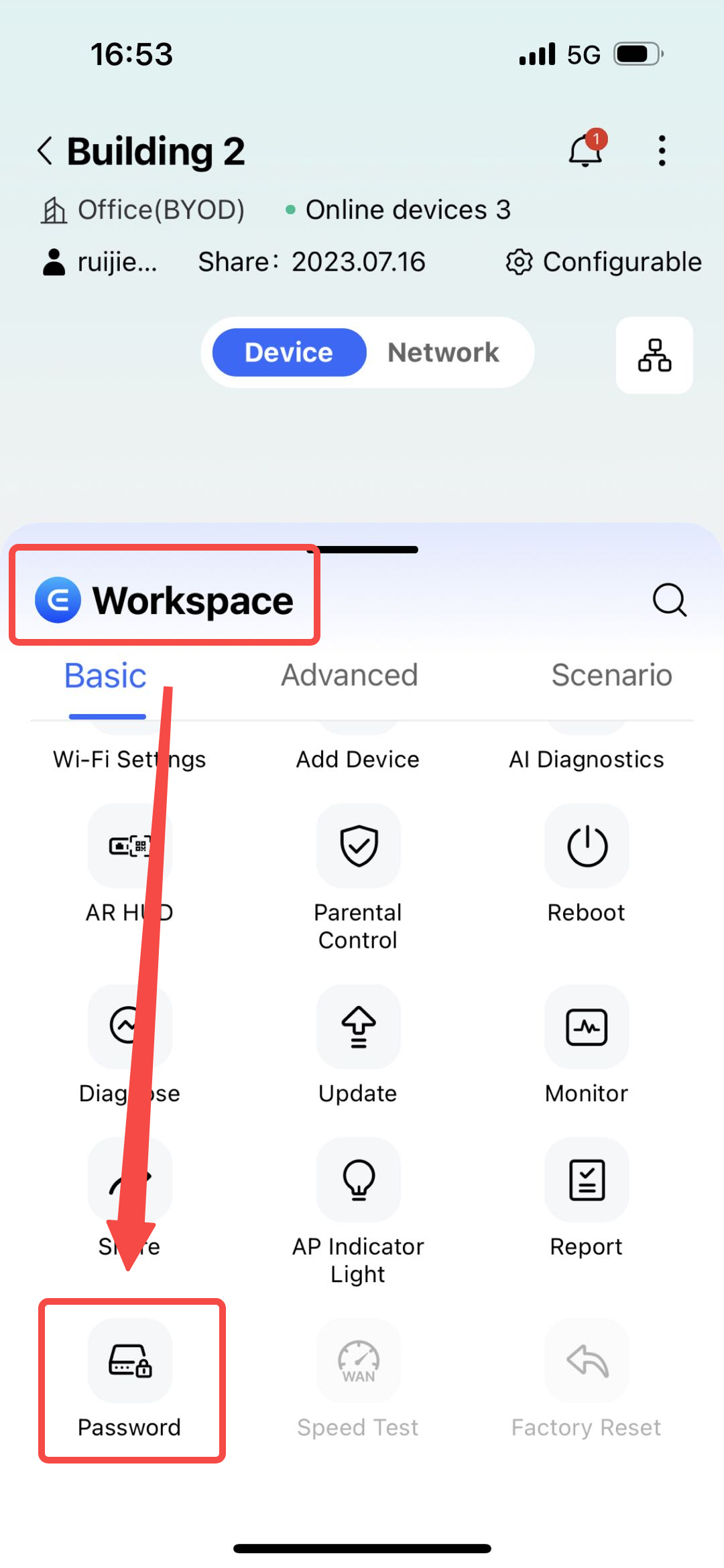

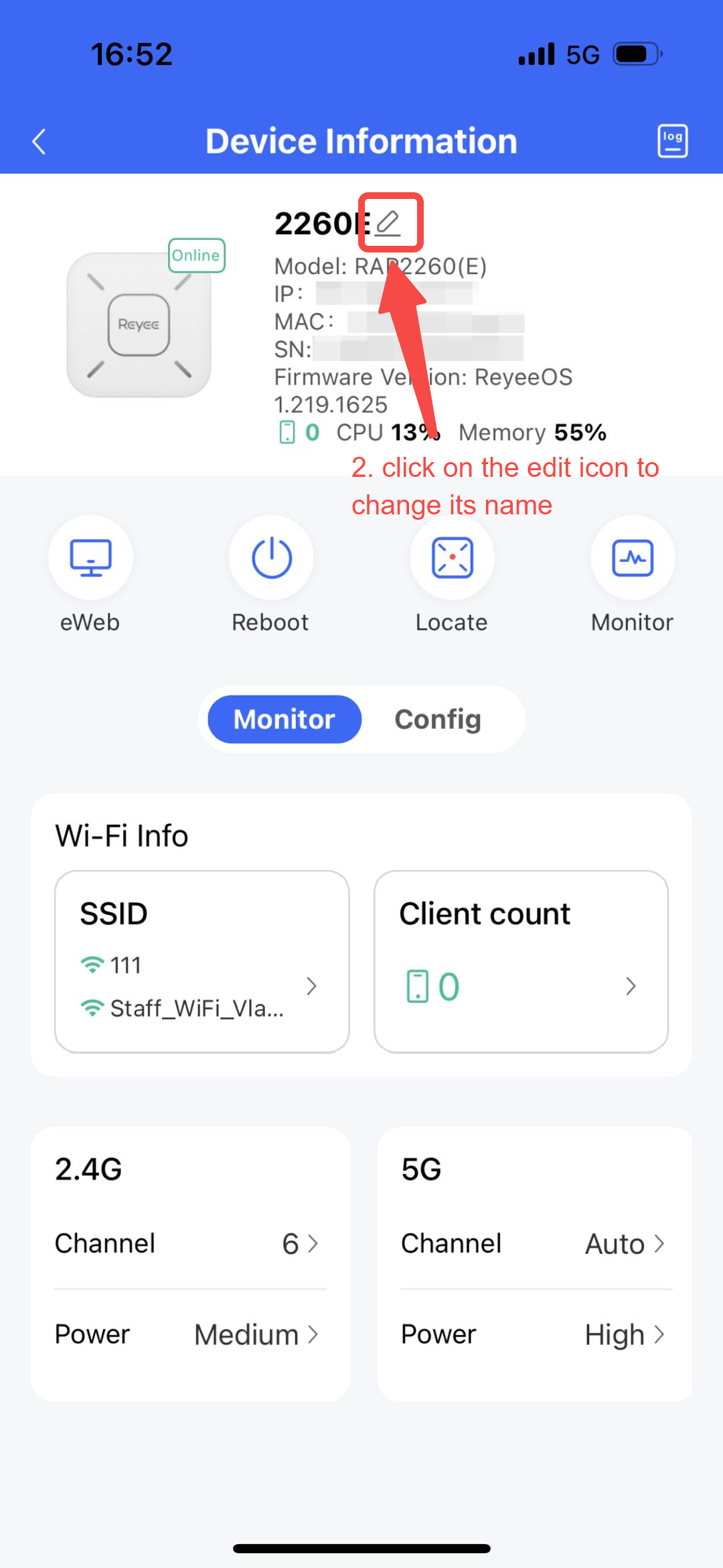

If you want to change the password of 1 AP only, you can reset the AP and move it to another project and it will use the other project password as its management password. Please note that Reyee devices in the same project cannot have different passwords. You can change project password on Ruijie Reyee App as below:
On Ruijie Reyee App, you can change the device name as follows:
