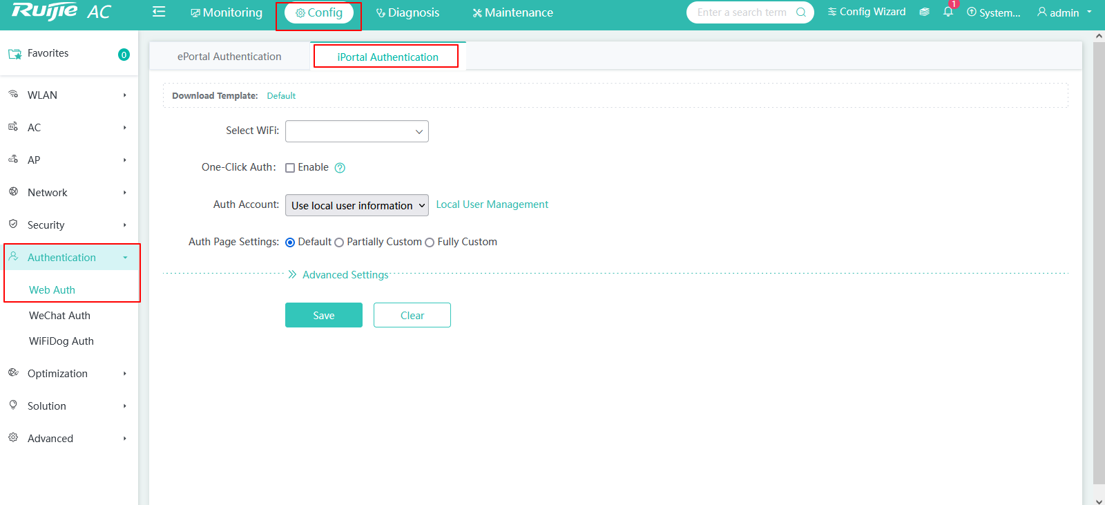

You can click Config > Authentication > Web Auth and configure iportal authentication on this page:
Here is the web-based iportal authentication steps hope can help you, you can refer to the guide on page 99:
https://www.ruijienetworks.com/resources/preview/75258
