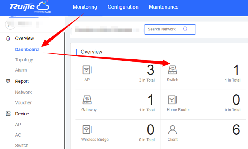

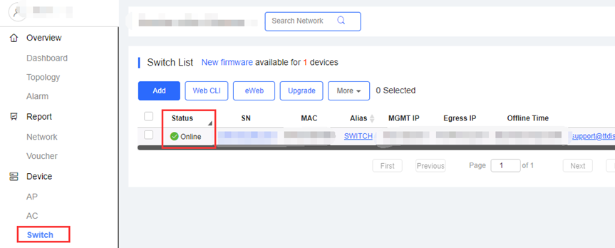

Method One: You can Click[Monitoring]-->[Switch]

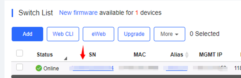

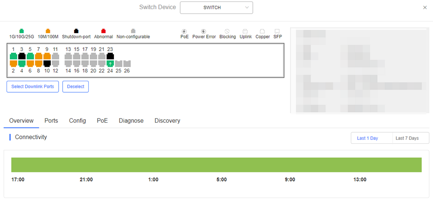

Method two: You can click the SN of your switch, then you can see the basic information of your switch

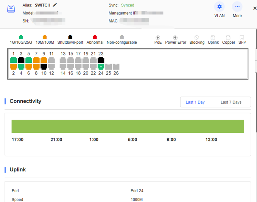

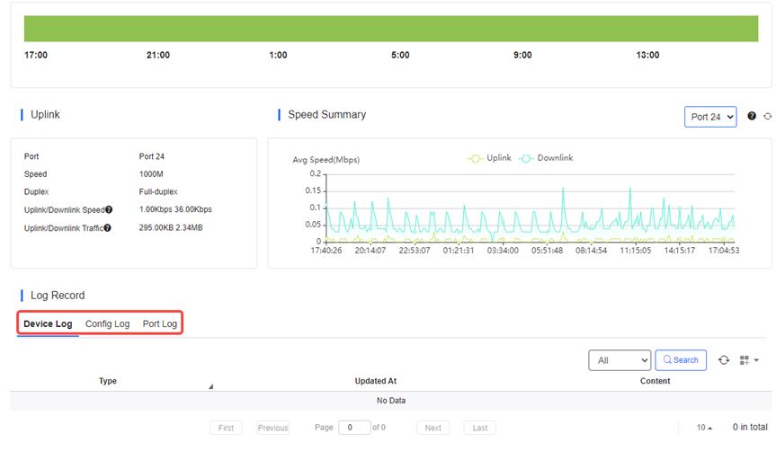

Method three: You can Click[Monitoring]-->[Topology]-->[Switch] you can also monitor the status of the switch here.
