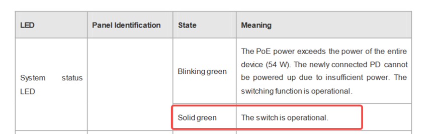

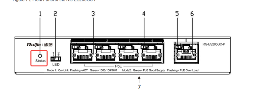

1. Check whether the status light of the device is normal.

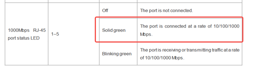

2. Use the LAN cable to connect the port of the PC and switch, and check whether the switch port is normally on.
