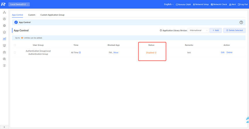

You can check according to the following steps to troubleshoot when APP control can not work on Reyee EG

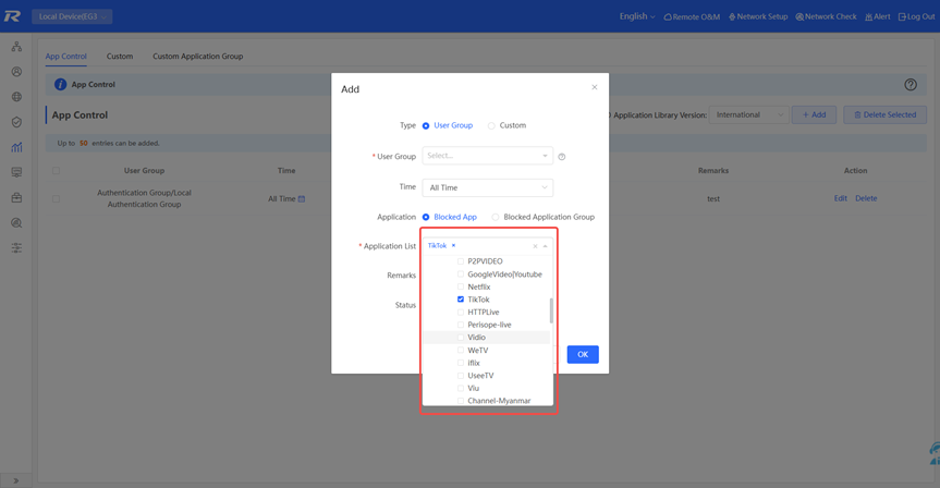

1. Check if the app you need to block is selected.

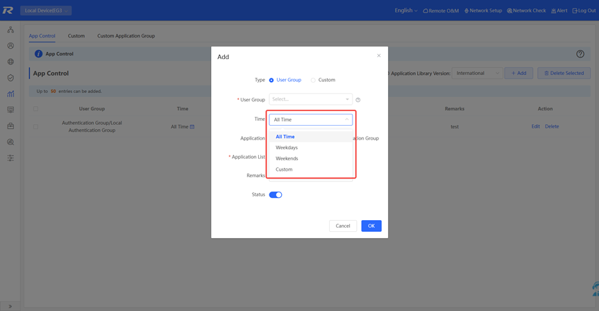

2.Check if the effective time of the policy matches your test time

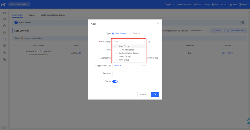

3.Check that the test user's IP address is in the range you selected

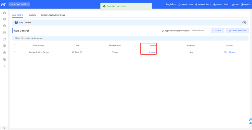

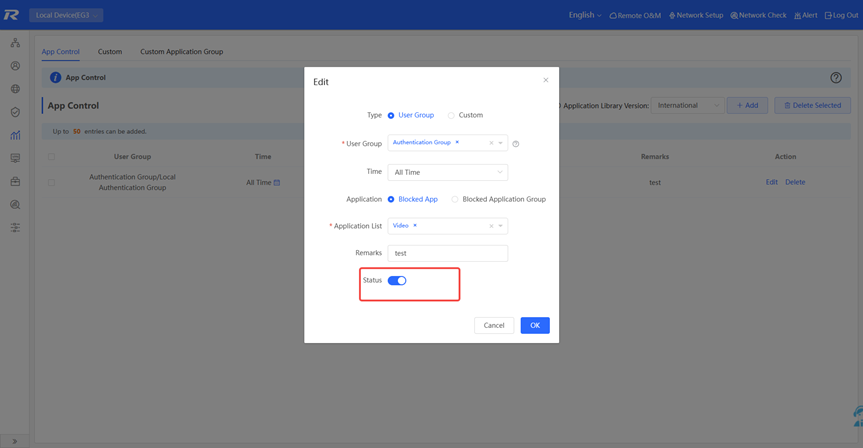

4. Check whether the status of the policy is 'Enable '. If it is 'Disable', you can click to activate it.

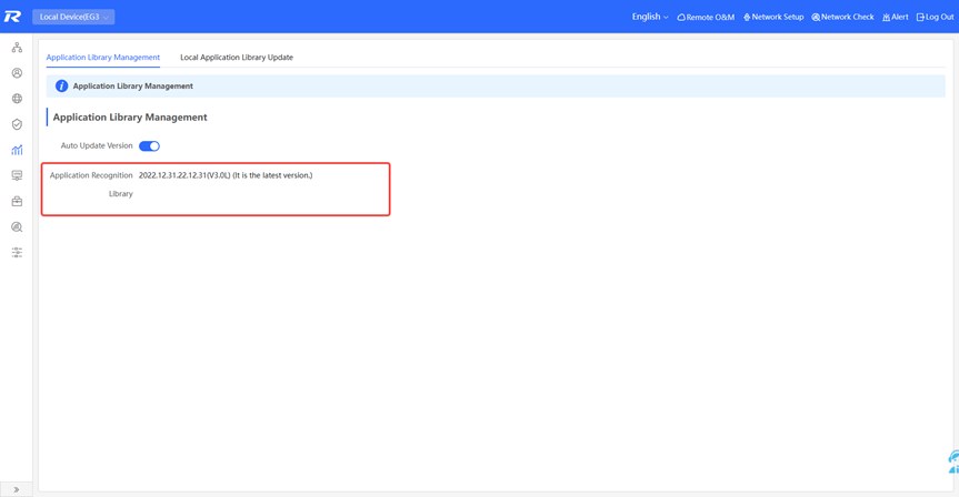

5. Check that Application Library Management is the latest version. You can turn on Auto Update Version
6. When testing, you need to empty the background program of the mobile phone.
