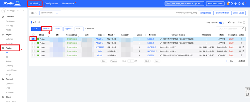

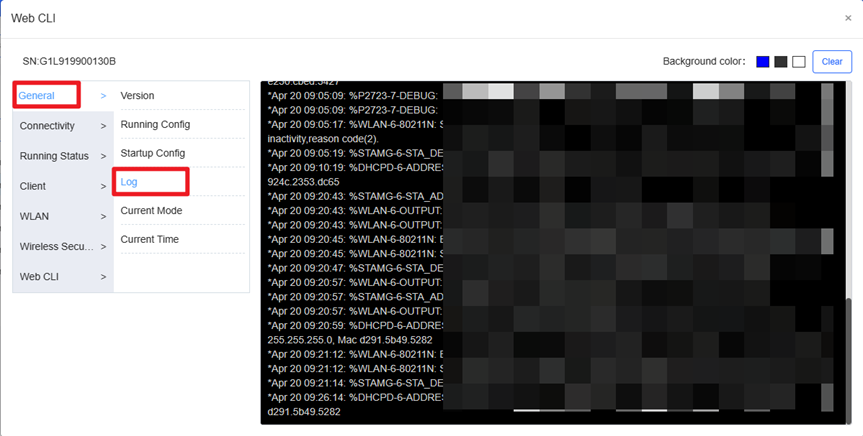

Detailed log
1) Monitoring>Device>Select the target device>Web ClI
2) Then the Web CLI page will be displayed. Click Log to check the logs of the device.

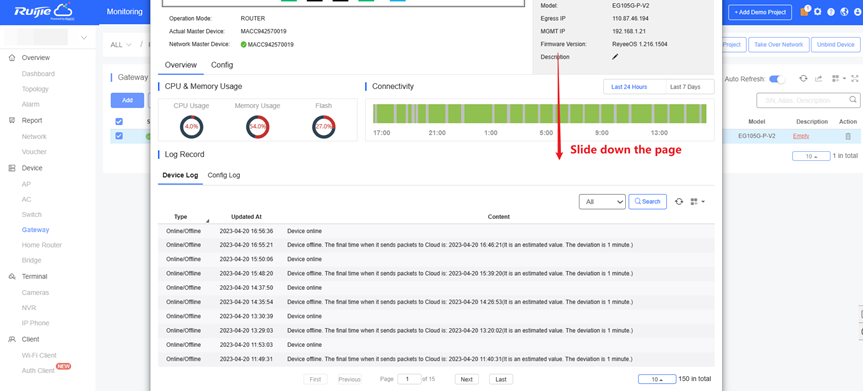

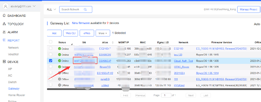

Device log
Web view:
1) Click the SN of the device in the list to enter the config page
2) You can see the device log (Device online, offline, restart) on the bottom of the displayed page.

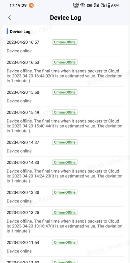

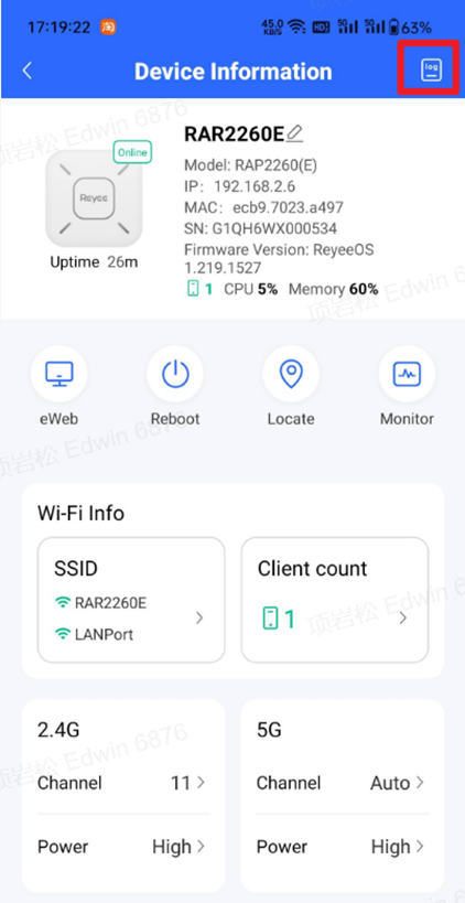

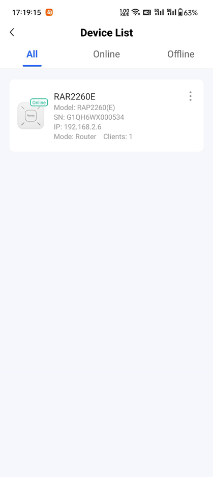

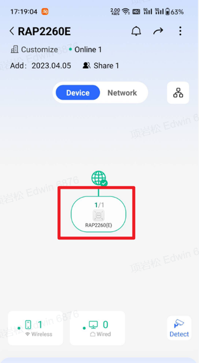

Mobile view
1) Click the icon of the device
2) Click the device to enter the second page.
3) Click Log
