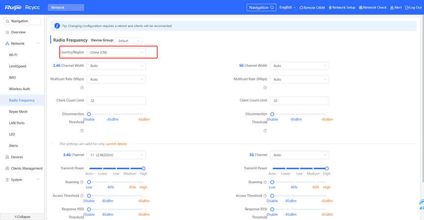

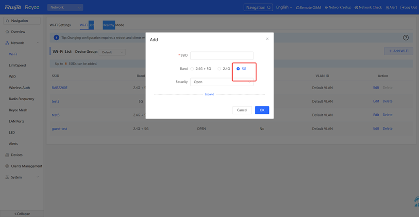

You can check according to the steps below.
1. Check if the device's SSID configuration has 5G turned on. You can create a 5G SSID only for testing
2. Confirm whether your test terminal supports 5G

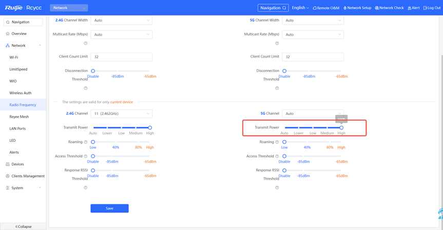

3. The recommended 5G coverage of EAP602 is 150 meters. Please ensure that the test equipment is within the coverage during the test, and the power can be adjusted to the maximum to check whether it can scan the 5G SSID.
4. Check if the country code is selected as the current country
