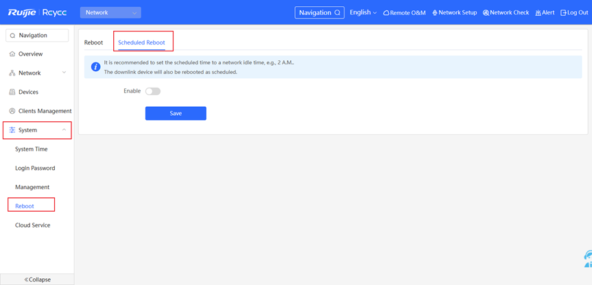

1.        RAP sets a scheduled reboot:

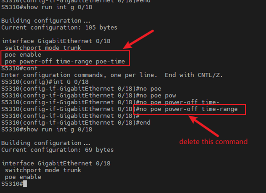

2.        RAP lose power supply due to the poe function is scheduled disable on the uplink switch. You need check on the uplink poe switch

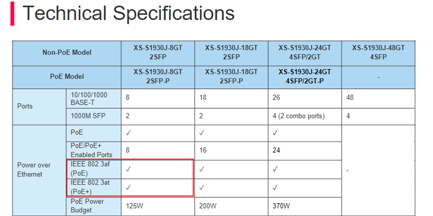

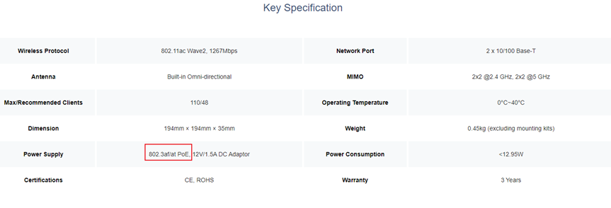

3.        The power supply standards of the AP and poe  switch are inconsistent

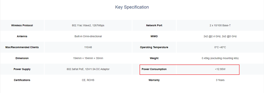

Check on AP datasheet

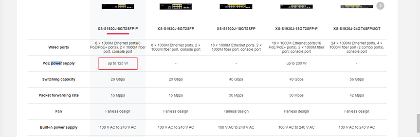

Check on Poe switch datasheet(XS-S1930J-8GT2SFP-P for example):
4.        The power supply to the uplink POE switch is insufficient
1). Check the power consumption of AP
2). Check the power supply of poe switch(XS-S1930J-8GT2SFP-P for example)
3). Check whether AP number x power consumption is within the power supply range of the switch
