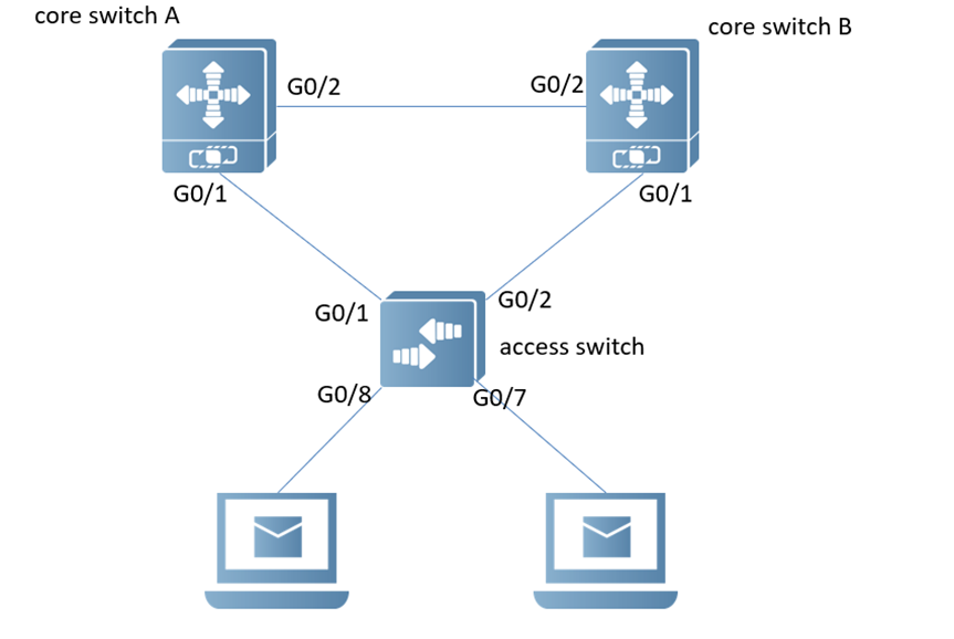

1.        Network requirements
There are 4 vlans on the Intranet. The root bridge of vlan10 and 20 is on core switch A, and the root bridge of vlan30 and vlan40 is on core switch B
2.        Topology

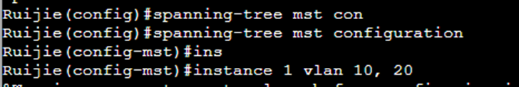

Ruijie(config)#spanning-tree mst configuration    //configure mst
Ruijie(config-mst)# instance 1 vlan 10, 20           //vlan 10 and 20 use instance1
Ruijie(config-mst)# instance 2 vlan 30, 40            //vlan 30 and 40 use instance2

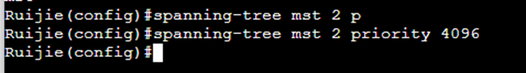

Ruijie(config)#spanning-tree mst 1 priority 4096   // instance 1 priority is 4096. The smaller, the higher priority  is selected to be root. 32768 by default

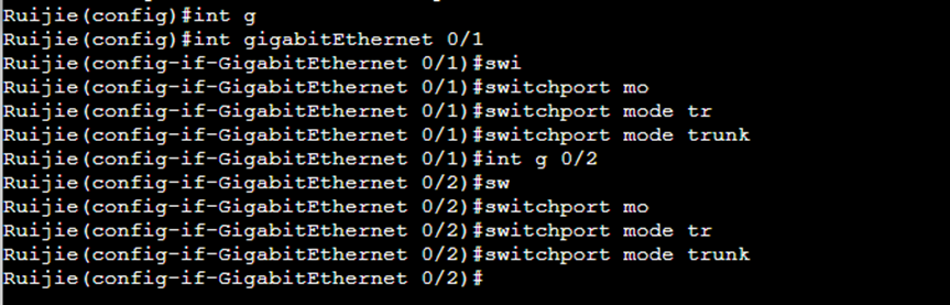

Ruijie(config)#interface gigabitEthernet 0/1
Ruijie(config-if-GigabitEthernet 0/1)#switchport mode trunk
Ruijie(config)#interface gigabitEthernet 0/2
Ruijie(config-if-GigabitEthernet 0/2)#switchport mode trunk

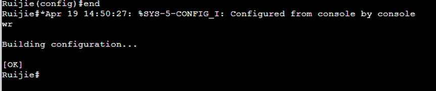

Ruijie(config)#end
Ruijie#write

Ruijie(config)#spanning-tree mst 2 priority 4096   // instance 2 priority is 4096. The smaller, the higher priority  is selected to be root. 32768 by default.

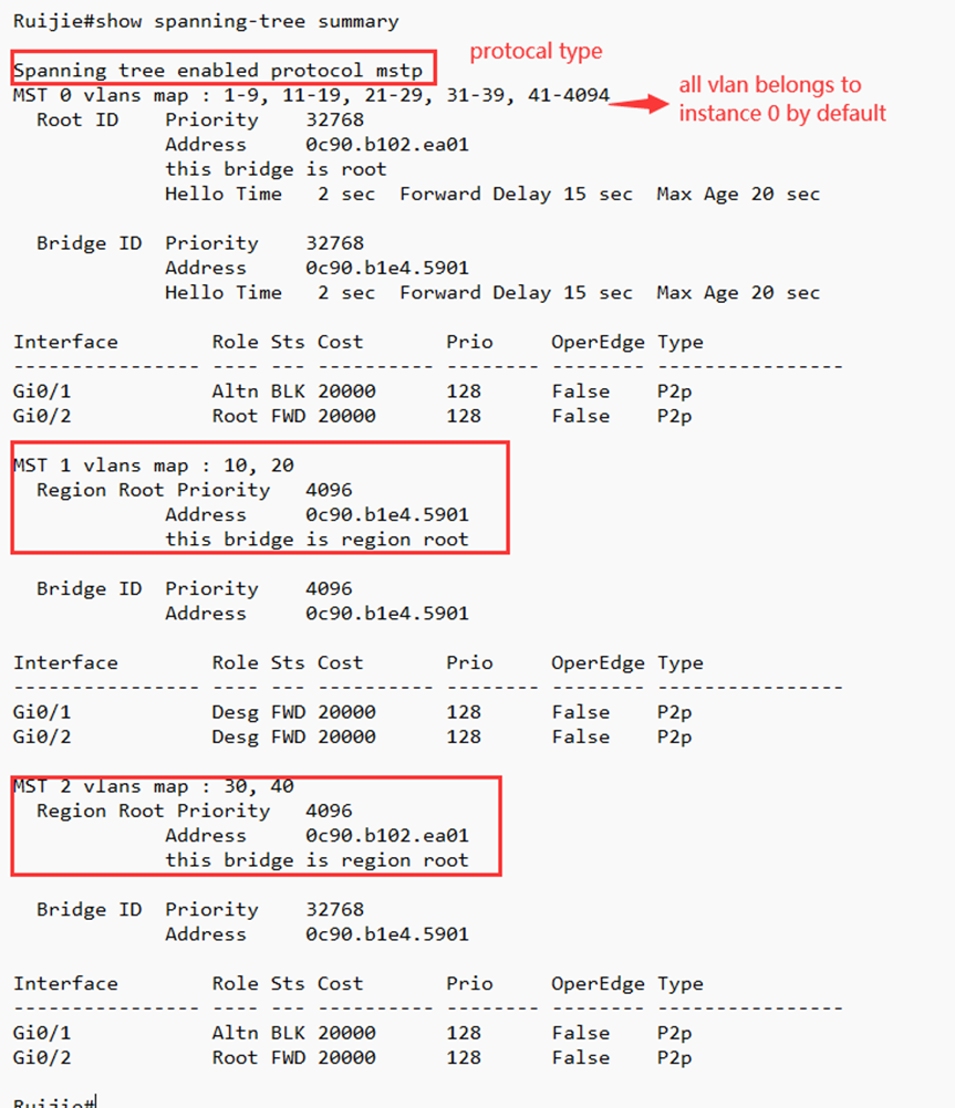

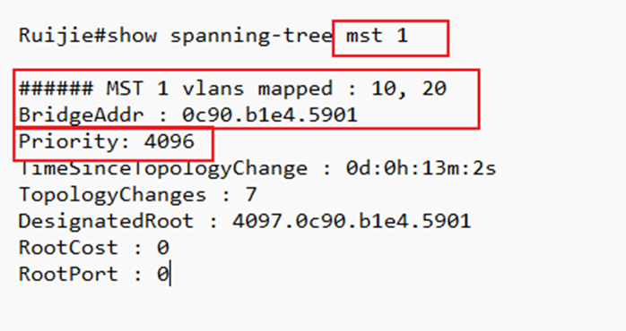

5.        Verification
Ruijie#show spanning-tree summary
Ruijie#show spanning-tree mst 1
