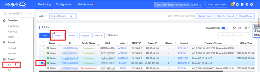

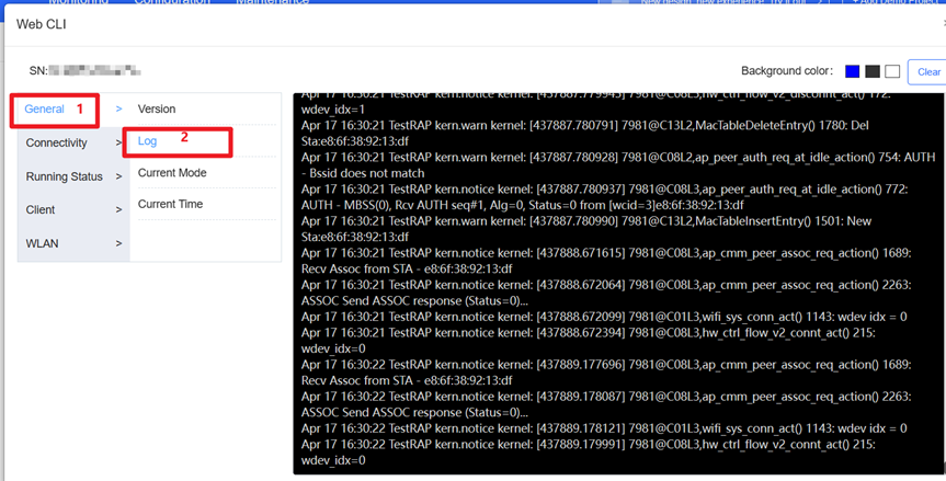

How to check logs in SON master on Reyee AP? Reply
3025 0 2023-8-14 15:49:13
You can check logs in SON master on Reyee AP if the master device is online cloud. Because AP does not support viewing log information locally.
RG-RAP6262(G)
Configuration Wireless
