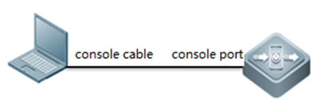

Access the CLI of a Ruijie switch using a console cable.
2.        Network Topology:
3.        Configuration Key Points:

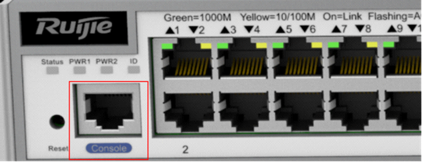

b.        Check the console port on the switch: a port on the switch panel labeled as Console.

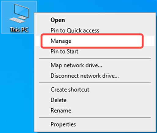

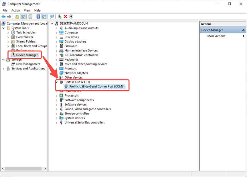

c.        Open Computer Management by right-clicking This PC and clicking Manage; open Device Manager; expand the category Ports and look for the correct COM port number.

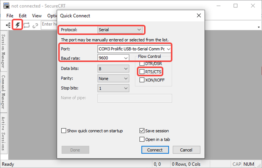

d.        Open Quick Connect on SecureCRT, and enter the COM connection information; select Serial for the protocol, select the correct COM port, set the baud rate to 9600, and uncheck RTS/CTS (turn off the flow control function):
e.        Click Connect, and the window will display the hostname of the switch, and the appeared line of 'Ruijie>' means the connection is successful
