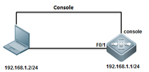

2.        Network Topology:

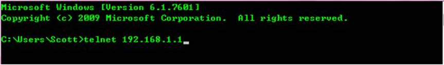

a.        Enter 'telnet 192.168.1.1' on Windows Command Prompt:

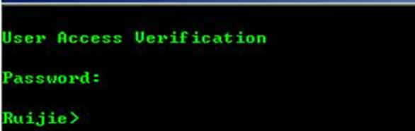

b.        A password (or a combination of username and password if Option 2 from above is configured) is required before accessing the switch CLI:

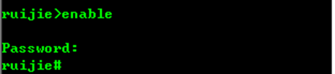

c.        Password is also required to enter privileged mode:

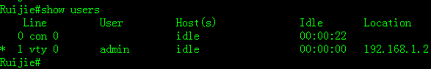

d.        Type 'show users' to view the users currently accessing the CLI:
In the example above, there is 1 console connection and 1 Telnet connection accessing the switch CLI from IP address 192.168.1.2
