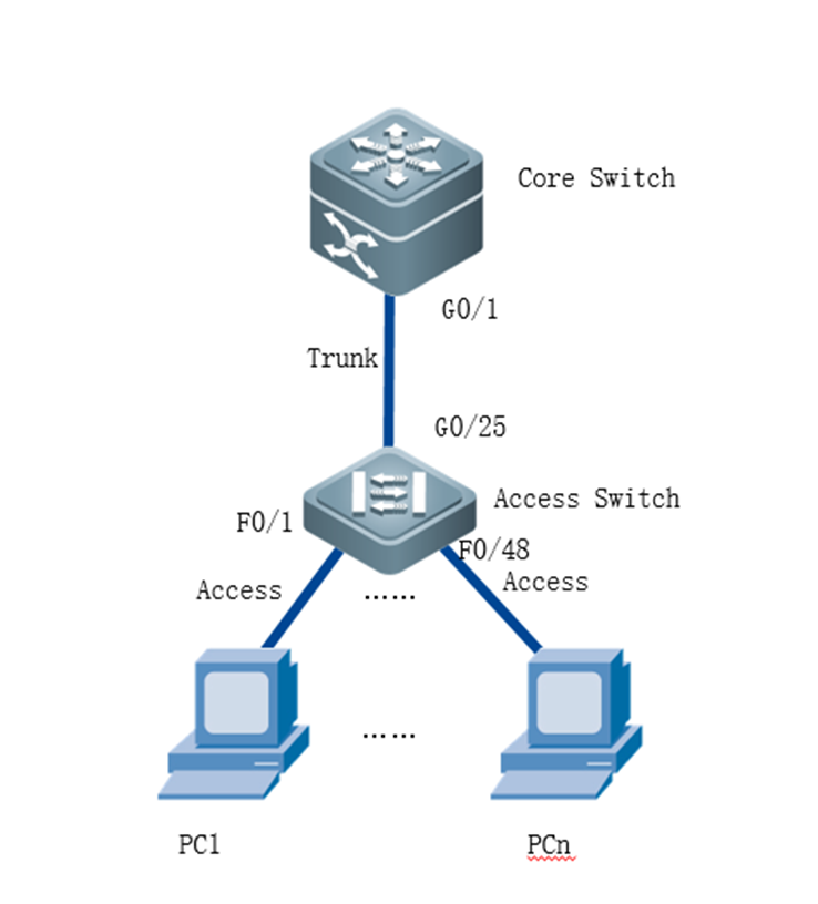

1. Networking requirements:
The core device is connected to 3000 users. One port supports a maximum of 200 users. The access switch supports a maximum of 200 users. Each port supports a maximum of 6 users. To prevent unauthorized attacks from occupying switch CPU resources, you need to adjust NFPP parameters to prevent attacks.
2. Networking topology:
3. configuration points:

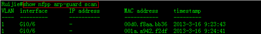

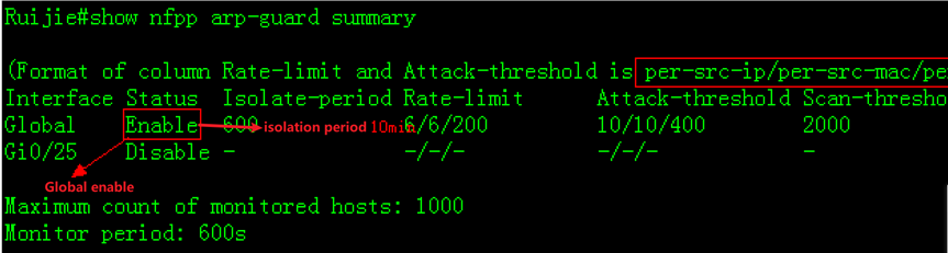

1) Check the global configuration of ARP-guard. (The threshold varies according to the software version.)
2)View the ARP-guard scanning table:

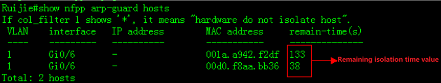

3)View the users isolated by ARP-guard:

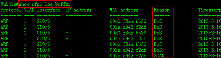

4)View the user in the log buffer
