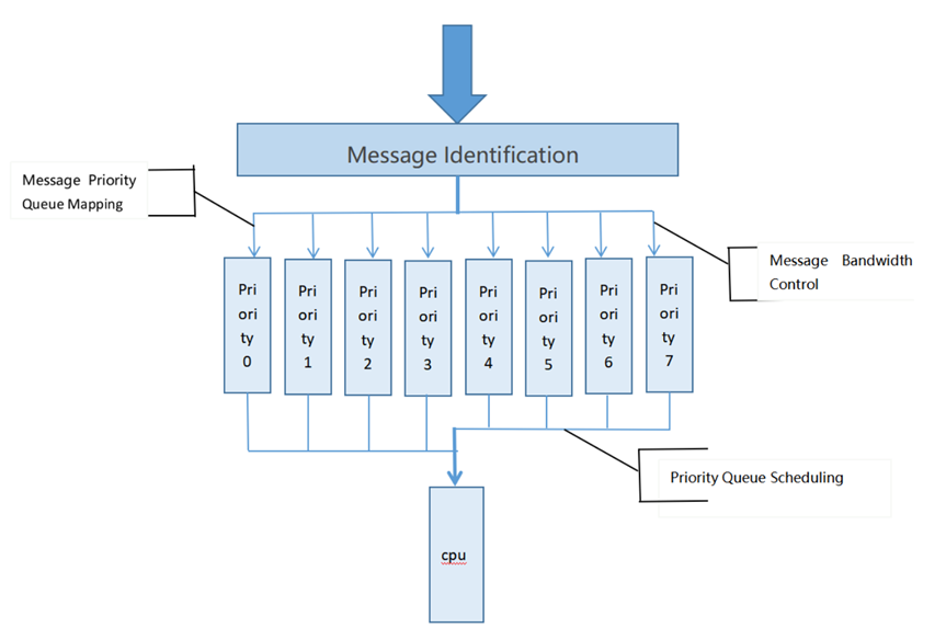

CPP: CPU Protect Policy (CPP) is used to prevent the CPU of network devices from receiving unnecessary and malicious data flows on the network, improving the security performance of network devices. You can also set the QoS filtering mechanism to ensure that the Control Plane (CP) of network devices can keep data forwarding and protocol status stable even under attack and high load.
In the figure above, CPU Protect Policy(CPP) protects switch processor resources and protects important packets through four technologies: packet identification, packet bandwidth control, packet priority queue mapping, and queue scheduling.
1) Message Identification
All packets sent to the switch for protocol processing are classified through the packet identification process, such as ARP, BPDU, and GVRP. (See CPU Protect Default Values for data classification of each product.)
2) Packet bandwidth control
The administrator can configure the bandwidth of each type of packet to effectively suppress high-rate attack packets on the network.
3) Packet priority queue mapping
The switch processor has eight priority queues. By configuring a priority queue for each type of packet, packets can be mapped to the corresponding queue.
4) Queue scheduling
To ensure that protocol packets of different priority queues can be sent to the CPU in time, the current polling scheduling algorithm is used. In the polling scheduling algorithm, the scheduling weight of each queue is equal.

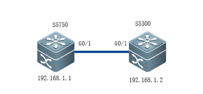

A S5750E switch is connected to a S5300 switch through a Layer3 port. The S5300 switch is detected to ping S5750E 18024 bytes packets, and packet loss is found regularly (about 3 packets are lost out of 1000 packets). The situation still occurs when the ICMP-Guard function of NFPP is disabled on two switches. After confirming that the CPP protection on the S5750E causes packet loss, you need to adjust the ICMP PPS value of the CPP in the S5750E.

2)network topology

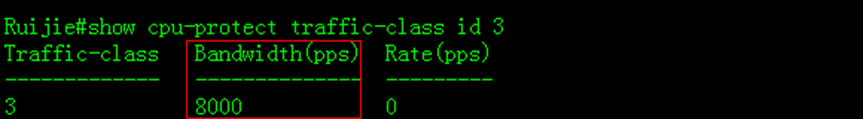

Ruijie(config)#cpu-protect type icmp bandwidth 5000 ------> Change the PPS value of ICMP to 5000
As a Ruijie(config)#cpu-protect traffic-class id 3 bandwidth 8000 ------> As the corresponding class of ICMP is 3, we also need to adjust the pps value of class 3, which is changed to 8000 here
Ruijie(config)#cpu-protect cpu bandwidth 10000 ------> Change the value of PPS sent to the cpu for processing to 10000
4)functional verification
Check the ICMP information about CPP on the S5750 Switch:
Check the pps value of queue 3:
