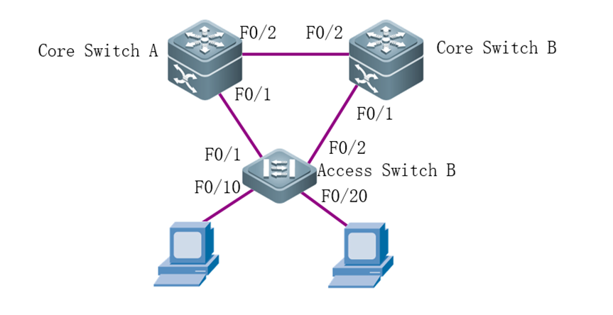

1. Networking topology:
2. Configuration points:
1)Enable the spanning tree function
2)Create different instances
3)Configure the priority for the instance
3. Configuration procedure:
