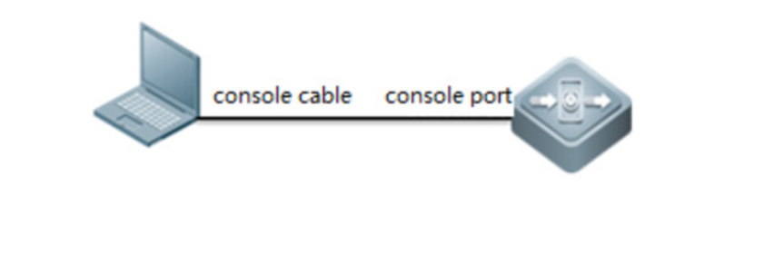

1.        Topology
2.        Configuration Steps
1. connect console cable to the switch

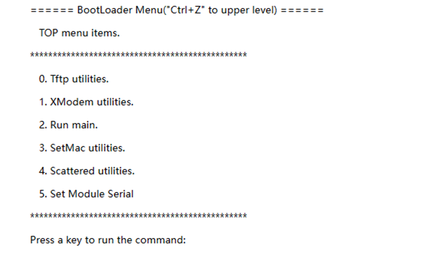

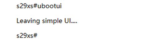

3). Press CTRL+ Q,then input "ubootui", press ctrl + p as soon as you hit enter

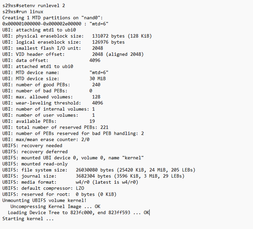

4). Then put the following commands:
s29xs#setenv runlevel 2
s29xs#run linux

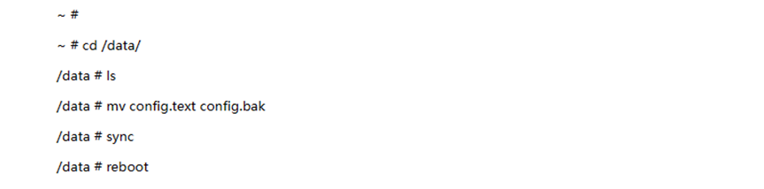

5). Run the following command and notice the space between the commands.
~ # cd /data/
/data # ls
/data # mv config.text config.bak
/data # sync
/data # reboot

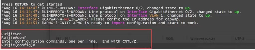

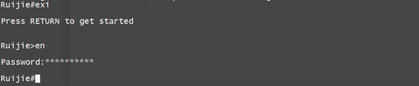

3.        Verification
Login in switch it can directly access

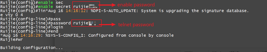

Set the new password for switch
