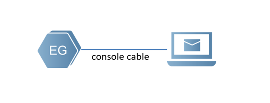

2.        Topology

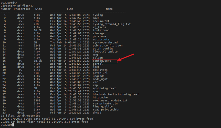

3.1 Confirm the current configure file.

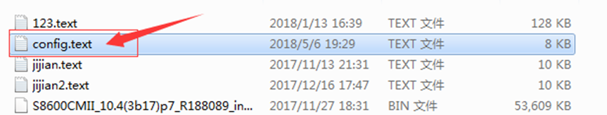

4.        Verification
Plug USB flash drive in PC and check the configure file
