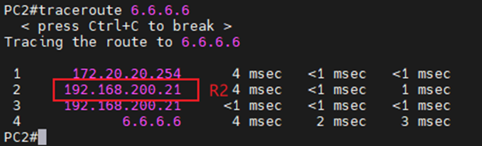

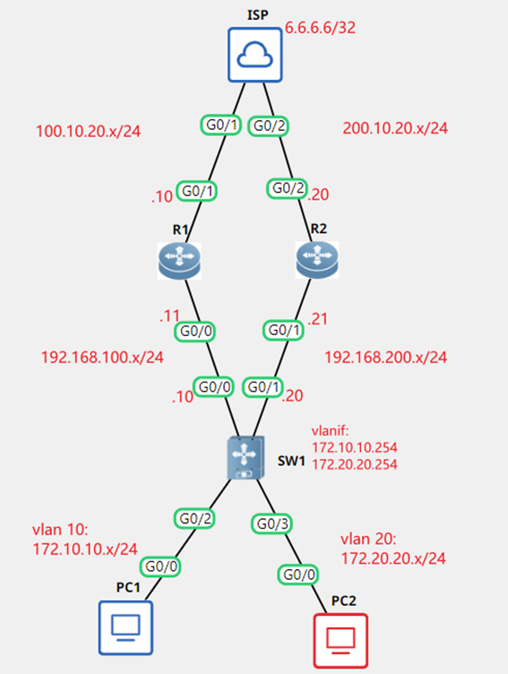

One Ruijie Switch is connected to 2 Ruijie gateway devices, R1 and R2.
Normally, we want users on vlan 10 to go to gateway R1 when accessing the Internet, and users on vlan 20 to go to gateway R2 when accessing the Internet.

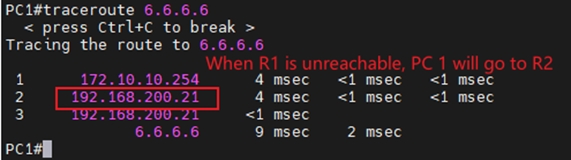

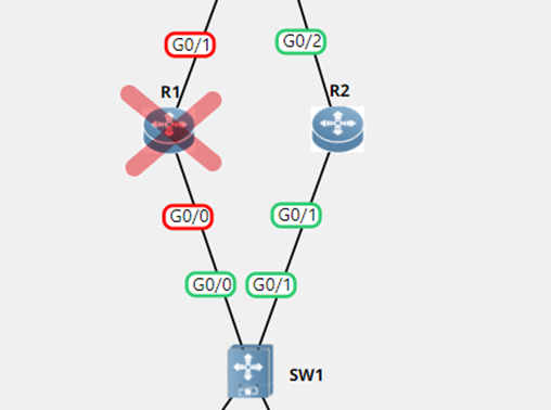

When failure occurs on gateway R1, vlan 10 will go to gateway R2.
2. Topology:
3. Configurations:

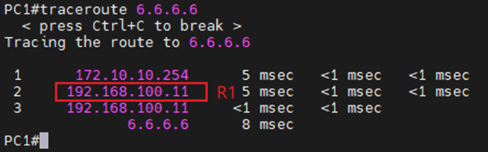

4.1 Traceroute on the PC when gateway A and B are working normally
4.2 Traceroute on the PC when gateway A fails but B is working normally
