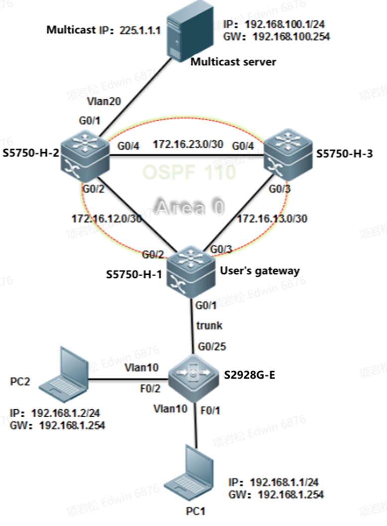

a) Requirement
1) S5750-H-1, S5750-H-2 and S5750-H-3 are three core devices. They are interconnected using a Layer 3 port and run OSPF, process 110, and all belong to area 0
2) The user PC's gateway is on S5750-H-1 and the multicast server is directly connected to S5750-H-2, which are each republished into the OSPF process
3) Layer 3 multicast routing protocol PIM-DM should be enabled on the S5750-H-1, S5750-H-2 and S5750-H-3 switches
4) Layer 2 multicast routing protocol IVGL to be enabled on the SS2928G-E switch
5) The PC downlinked by S29E is able to make on-demand video inside the multicast server
b) Network Topology
