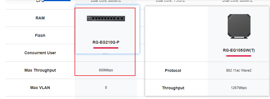

Is the RG-EG105GW(T) a gateway in addition to a router with the functions of the gateway such as VLAN's etc? Could I use it instead of a RG-EG210G-P gateway but with a higher throughput?

RG-EG105GW(T) can support vlan. You may check the following reference link:
https://www.ruijienetworks.com/resources/preview/77248
For the throughput, you can refer to the picture.
