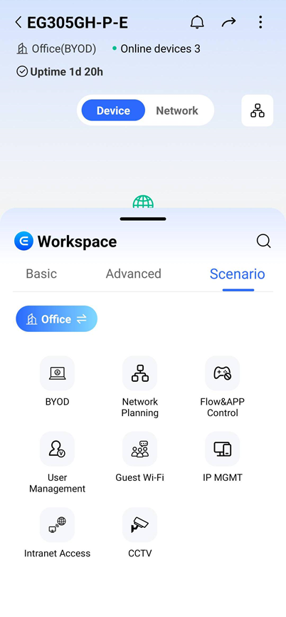

1. login to the Ruijie/Reyee APP, Click[Scenario], change the Scenario to office

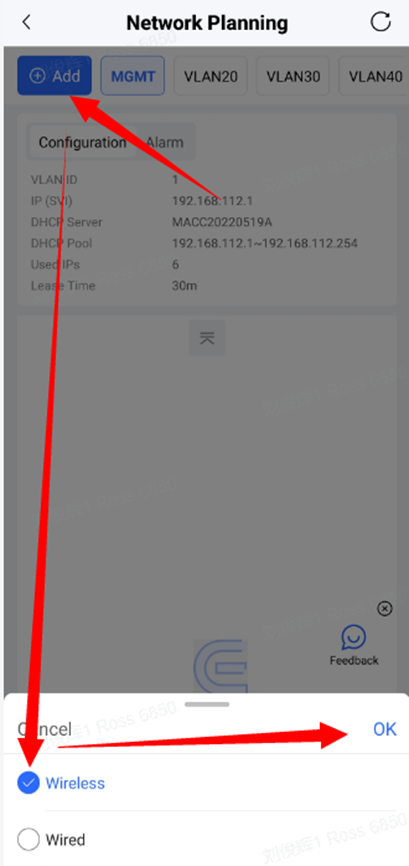

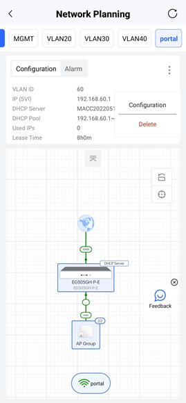

Click the [Networking Planning]

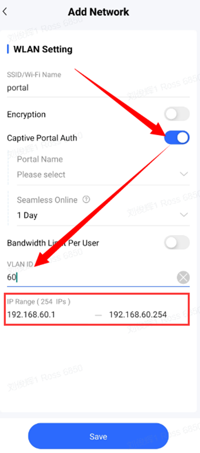

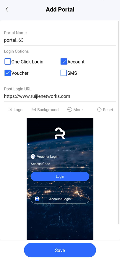

2. Configure the address segment for the captive portal, Select a portal page

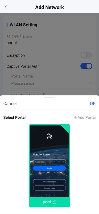

3. Configure the captive portal, Select the authentication method you want to configure

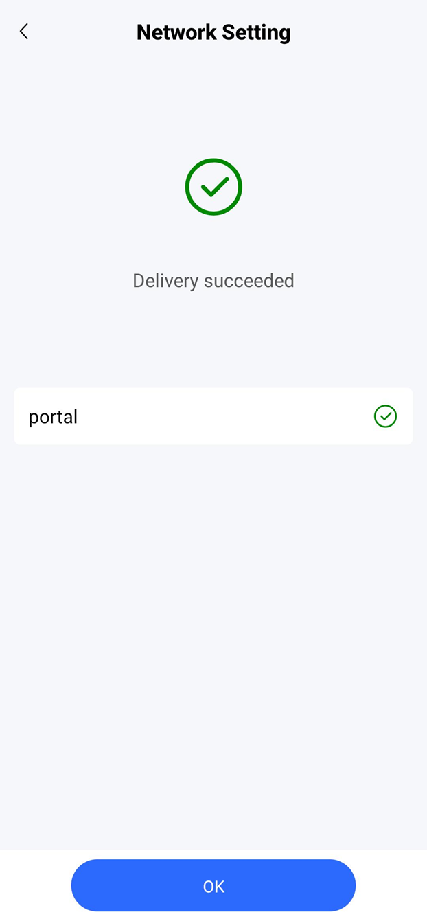

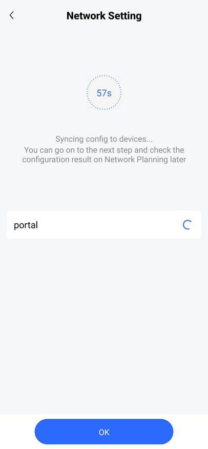

4. Check whether the portal configuration is successful

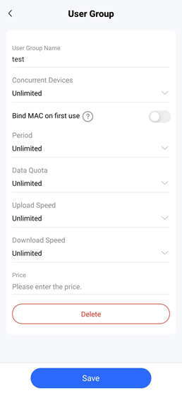

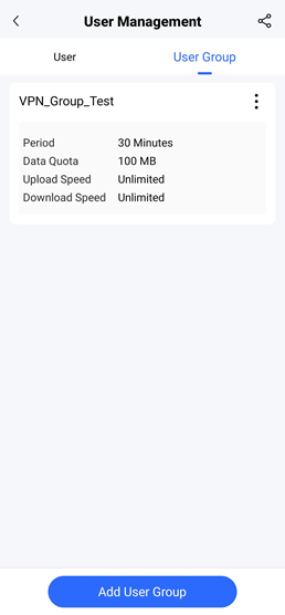

5. Configure Voucher for the captive portal, Click [portal]-->[User Group], configure User Group

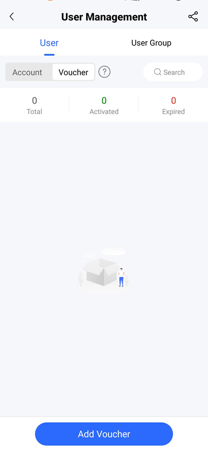

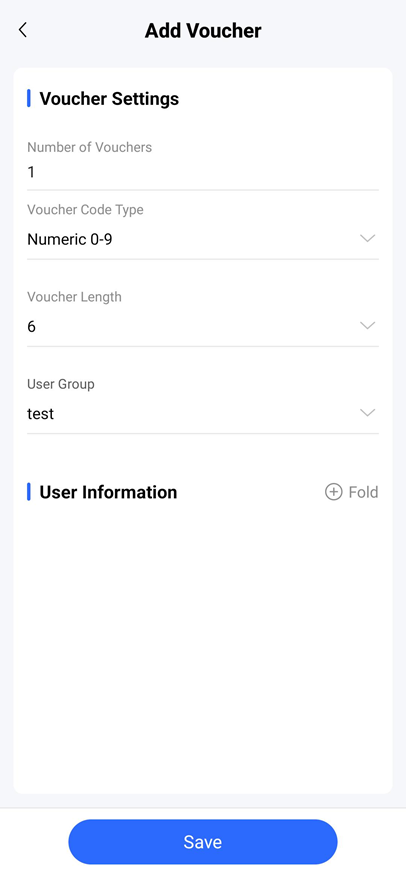

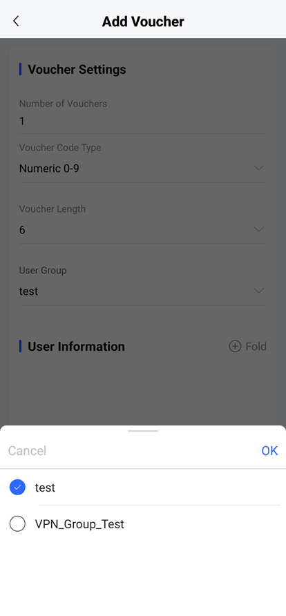

6.Click [User]-->[Add Voucher], configure Voucher Setting

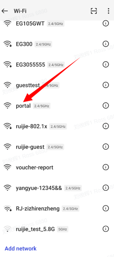

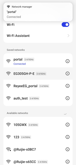

7. Select the corresponding User Group, and choose the corresponding SSID that has enabled the portal authentication(Select the portal you just configured, here is just an example(portal))

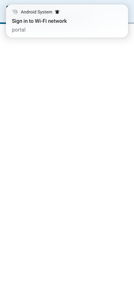

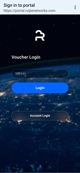

8. Check whether the portal configured by you can be connected normally and whether it can access the network normally after entering a voucher code
