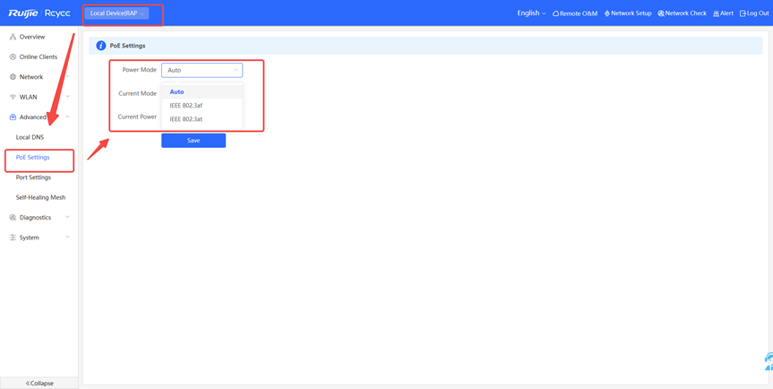

How to modify the poe mode of Reyee AP? Reply
4103 0 2023-8-17 14:08:40
Log in the web interface, Click Advanced->Poe Setting -> Power Mode
RAP6202(G)
Configuration Wireless
