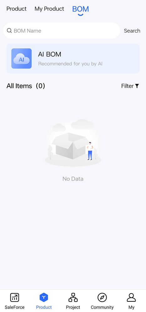

1.        Login to the Cloud APP, choose AI BOM

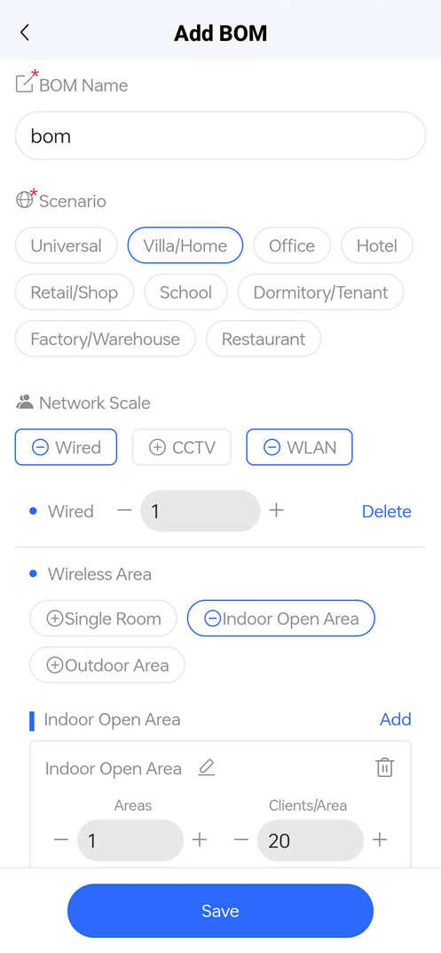

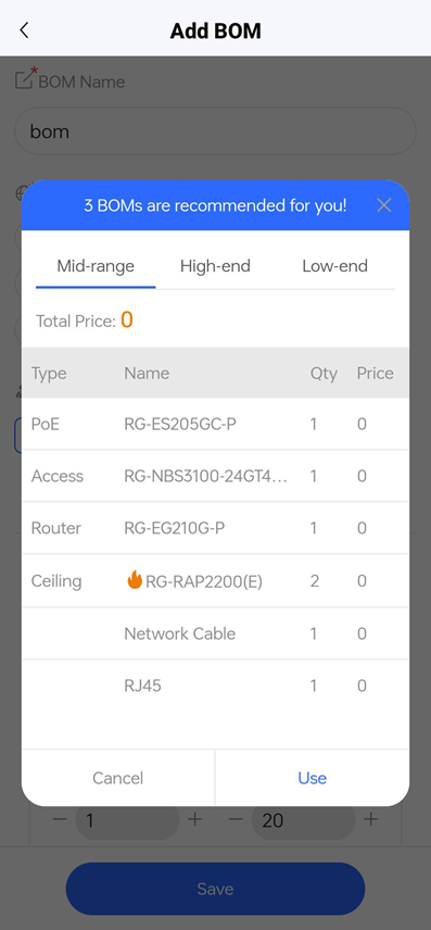

2.        Select your environment and the type of equipment you need

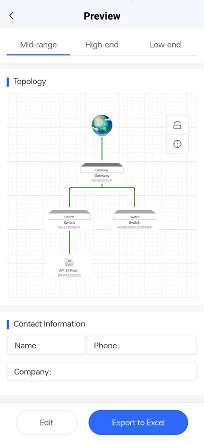

3.        After you complete the configuration of your requirements, the system will start to help you calculate the device model and network deployment diagram

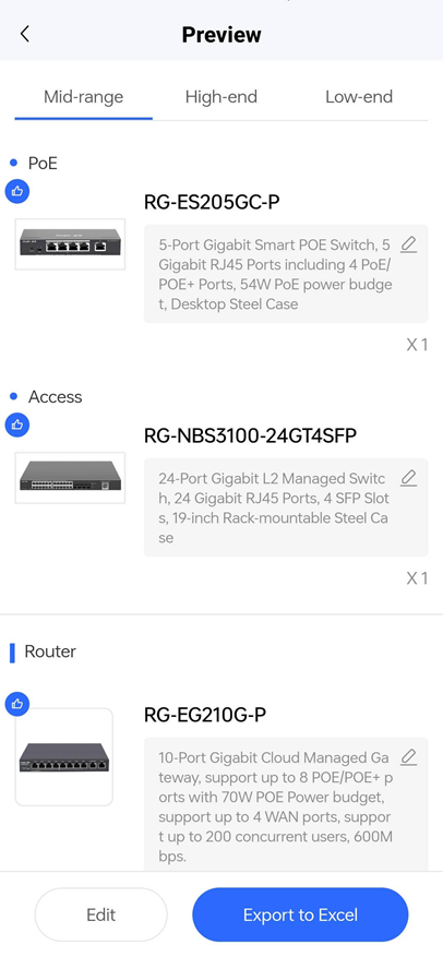

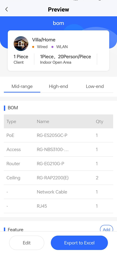

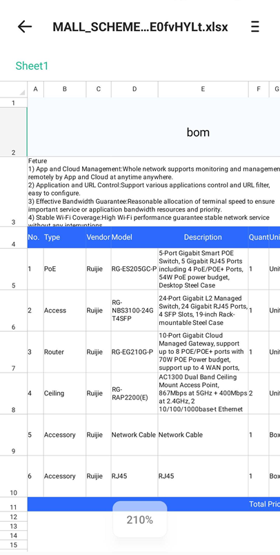

4.        Here you can see the specific model of your device and the number of the device you need to meet your requirement
5.        If you want to save device information for future deployment, you can export the information
