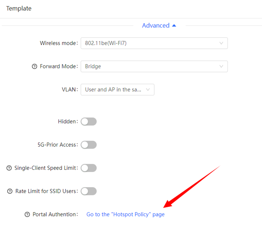

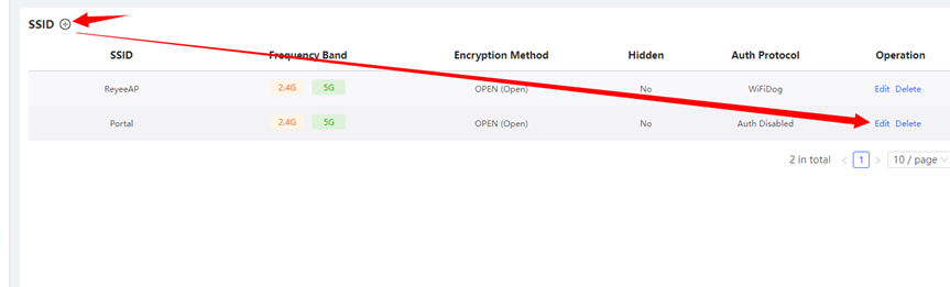

1. Create an SSID for captive portal
2. Edit the new SSID and redirect it to the hotspot page

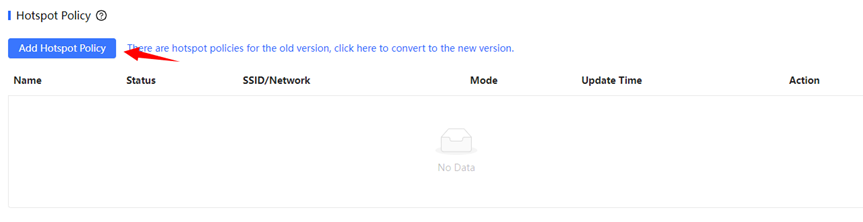

3. Add a new Hotspot Policy

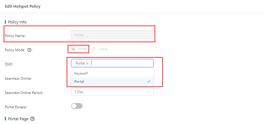

4. Name your Policy and select the correct SSID that you want to enable captive portal and the Policy mode should be Inner

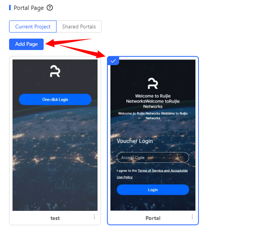

5. Add a new page for the captive portal, remember to click the corresponding page

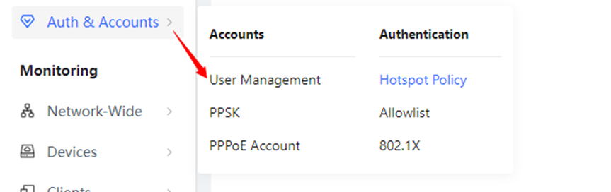

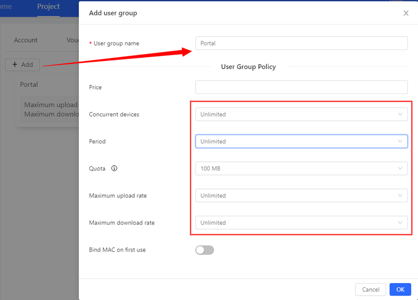

6. After finishing the Policy configuration, click User Management

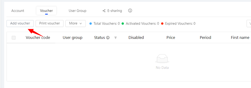

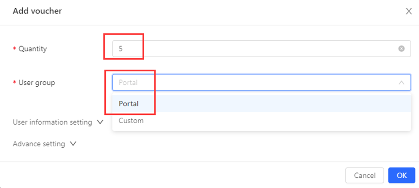

7.Add user group--->Add voucher(account), select corresponding user group

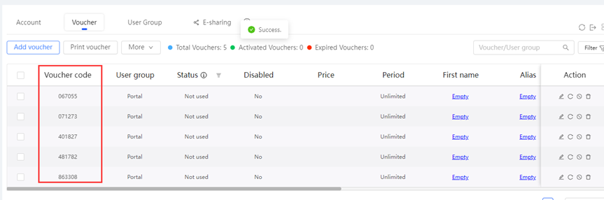

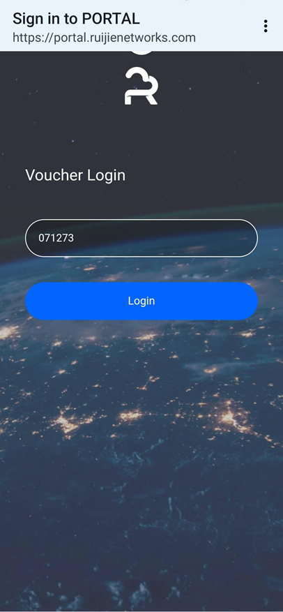

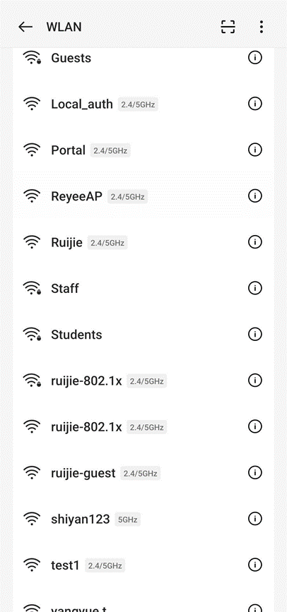

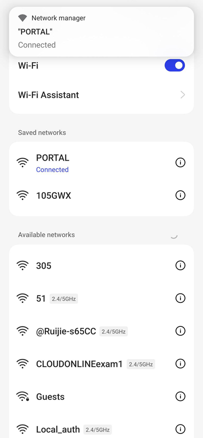

8. Find the corresponding SSID in the WLAN list, input the correct voucher code, then you can access the network properly
