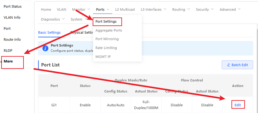

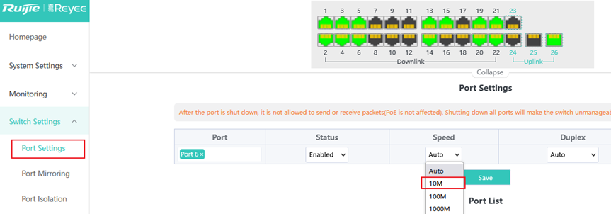

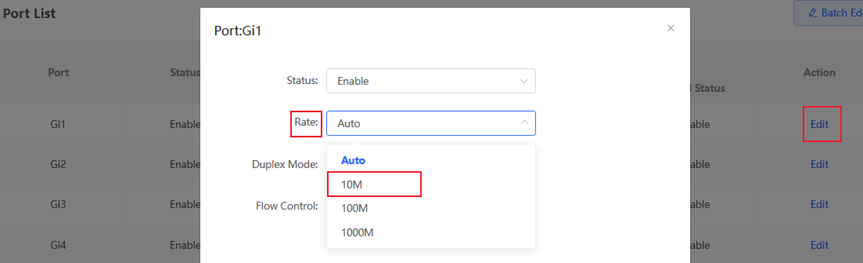

If you want to enable the 250m PoE on the Reyee Switch, you can change the port rate to 10M manually on the eweb of Reyee Switch.
For Reyee NBS switch:
For Reyee ES switch:
RG-ES208GC
Configuration Switch
