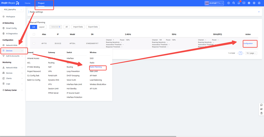

Click Project->Devices->Radio Planing->Configuration

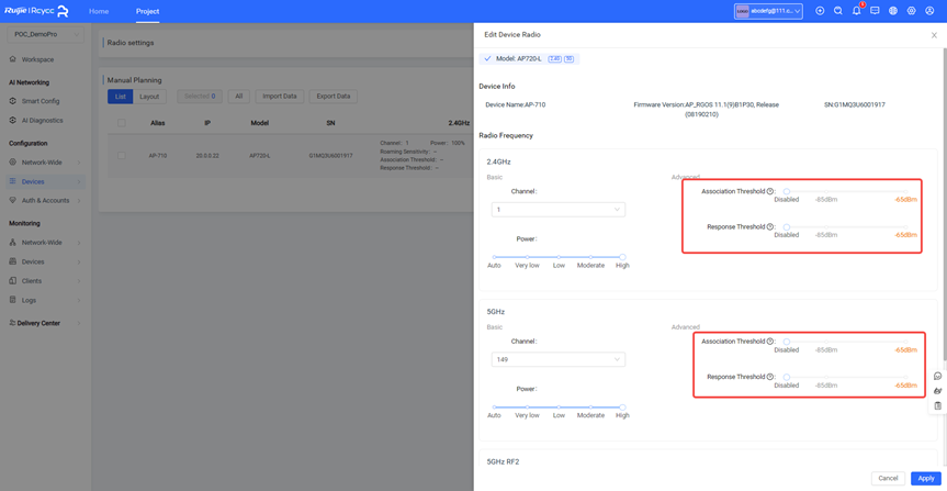

Response-Rssi:When the user accesses the SSID when the RSSI is lower than the set threshold, the user will not be able to access the SSID. If the user accesses when the RSSI is higher than the set threshold and then moves to a position where the RSSI is lower than the threshold, the user will not be kicked out
Assoc-Rssi:When the average RSSI of the user in a period of time is lower than the set threshold, the user will be kicked out, but if the user connects to this SSID again within ten minutes, the AP will not kick the user out again within ten minutes
