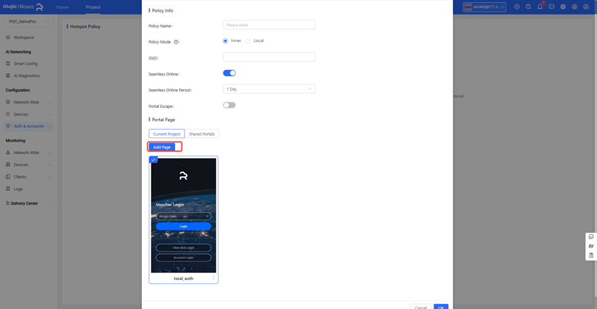

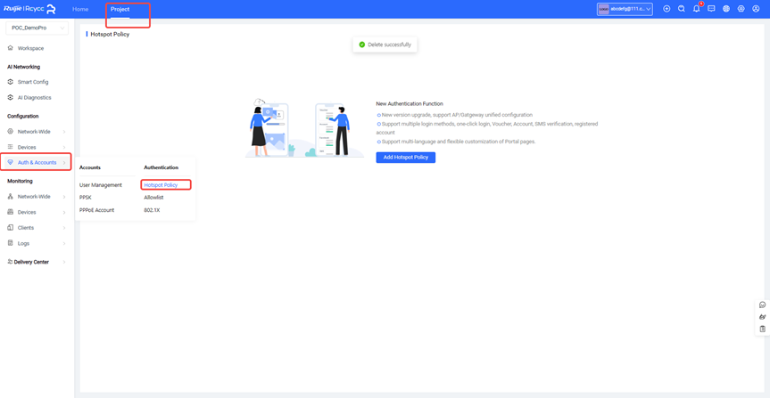

1)Click Project->Auth & Accounts->Hotspot Policy->Add Hotspot Policy

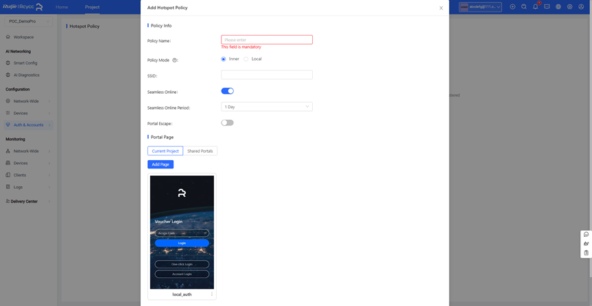

2)Set the project name and select Local or Inner
•        Inner: Cloud-based authentication. The built-in authentication server in the public cloud is used for authentication.
•        Local: Device-based local authentication and acceleration. Portal pages and accounts in the cloud are synchronized with the device for local authentication and acceleration.

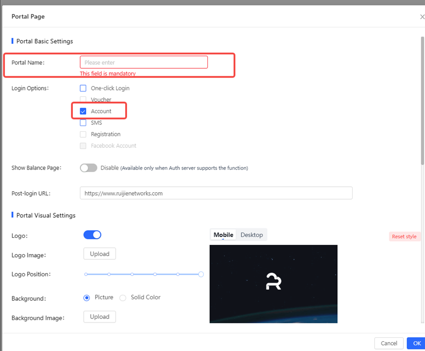

3)Add page then set the portal name, login option select Accounts and Click 'OK'

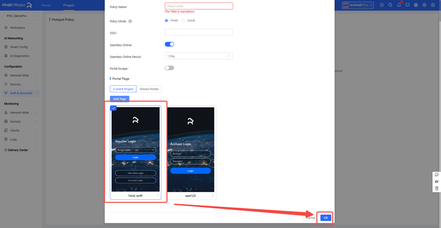

4)Select the portal template you created and click'OK '
