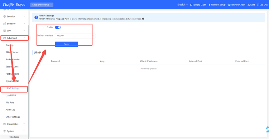

How to configure upnp on Reyee EG? Reply
4445 0 2023-8-18 09:59:31
Click Advanced->UPnP Settings-> Enable
UPnP is a protocol that enables applications running on a host to automatically configure port mapping on the NAT-Router. On the other hand, enabling UPnP may pose a potential danger to network security. There are three requirements for applying UPnP:
1.        The device must be enabled with UPnP.
2.        The operating system of the internal host must support UPnP.
3.        The application must support UPnP.
