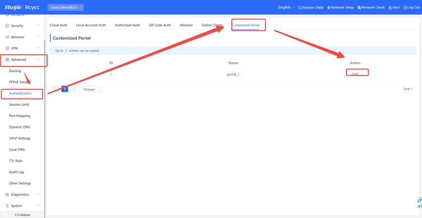

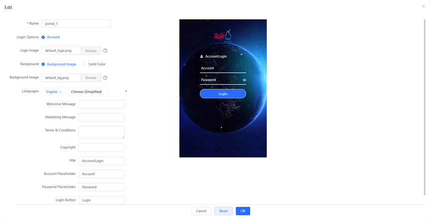

You can refer to the following guide to edit the portal interface in Reyee EG web interface locally.
Click Advanced->Authentication->Customized->Edit
