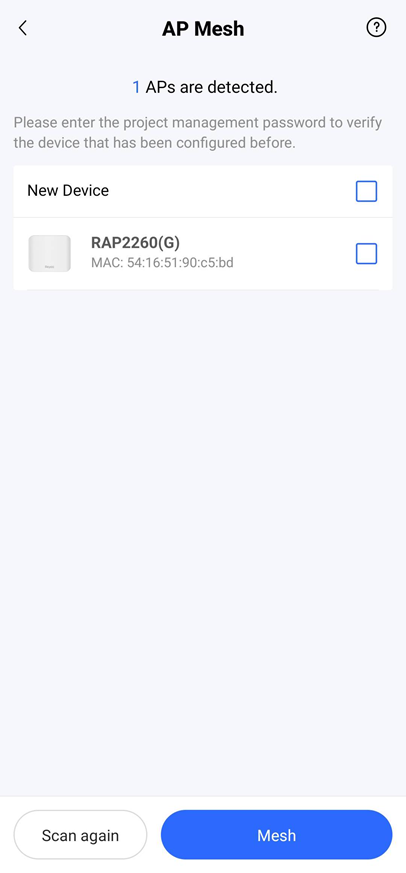

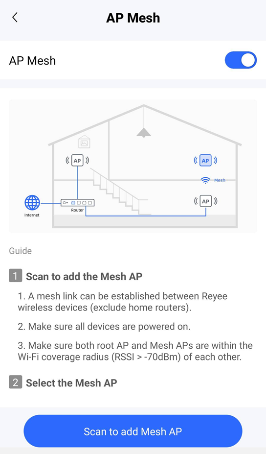

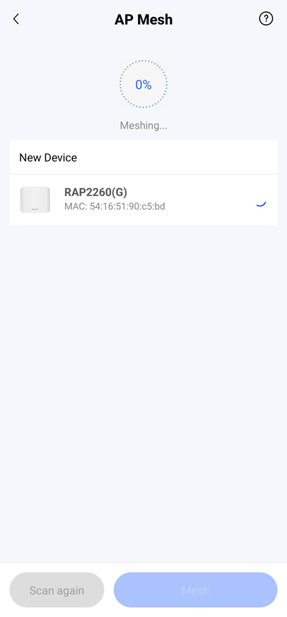

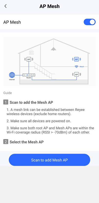

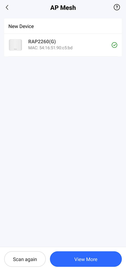

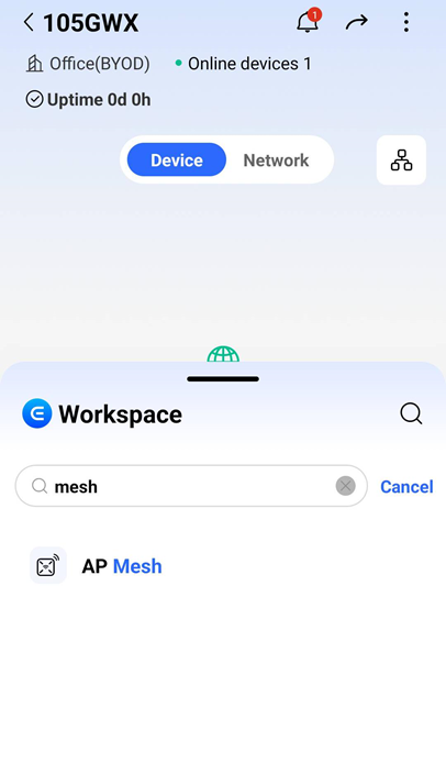

1.In the Ruijie/Reyee APP:
You can follow the following steps to configure the mesh

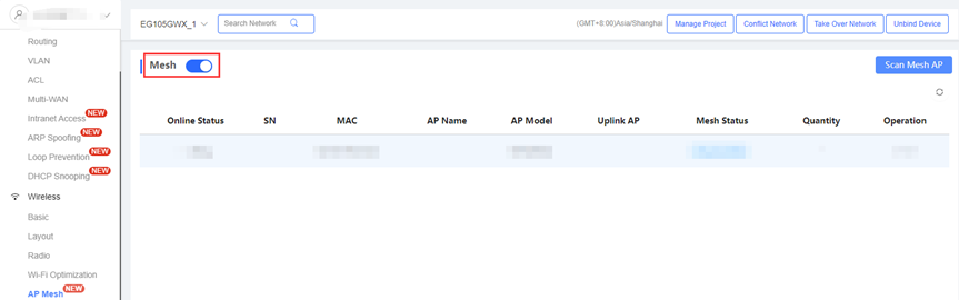

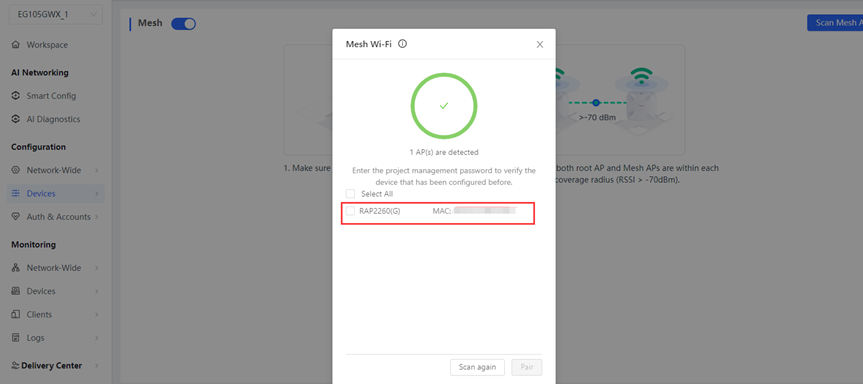

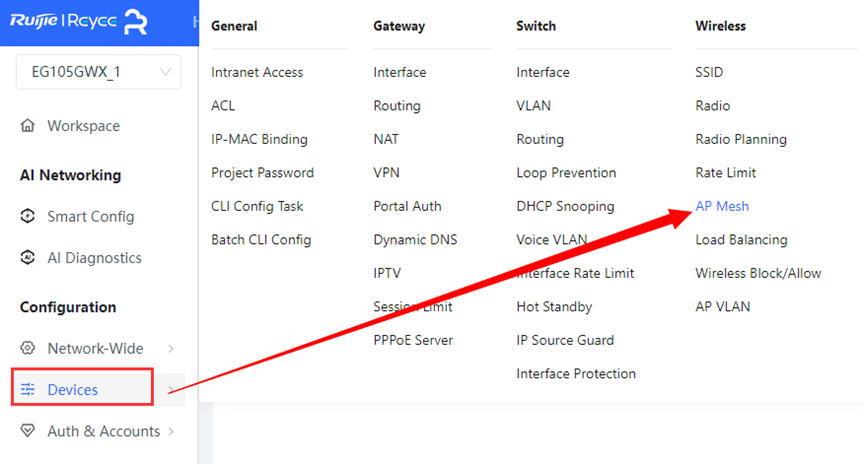

2. In the Ruijie Cloud:
(1).        Click [Device]-->[AP Mesh]

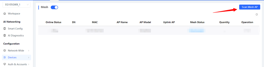

For the new cloud design:

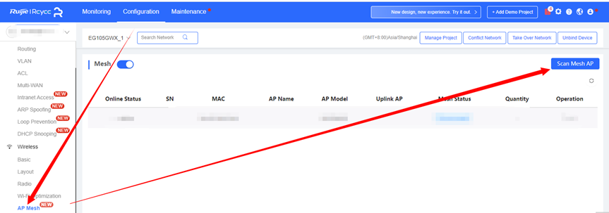

For the old cloud design:

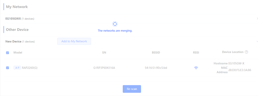

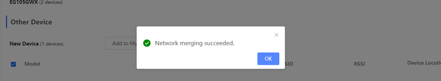

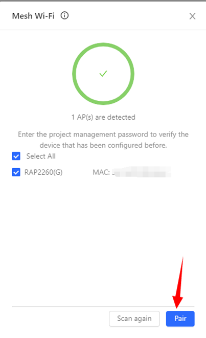

(2). Click Scan Mesh AP, generally it will take 2-3 minutes to search for Reyee AP

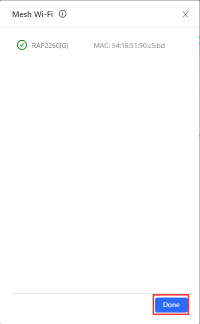

(3).        Select the AP that you want to mesh
Note: If AP has been merged into another SON network. It will need to be reset and removed from the original SON network, or the AP Mesh can not detect that AP

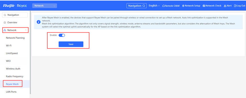

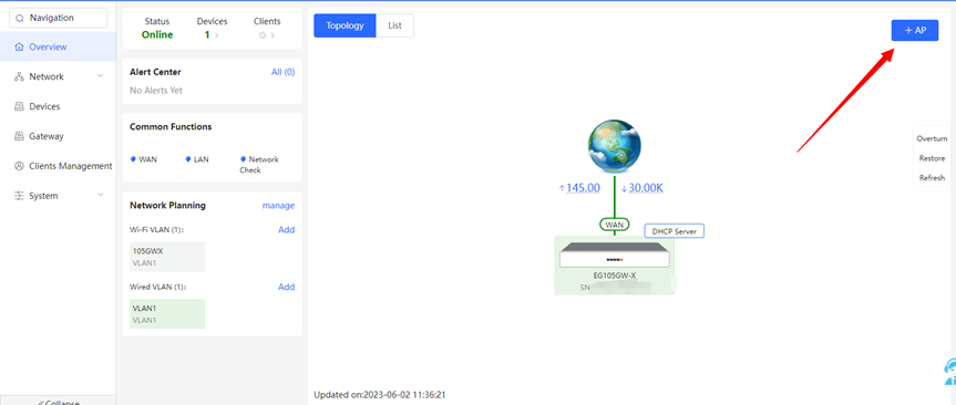

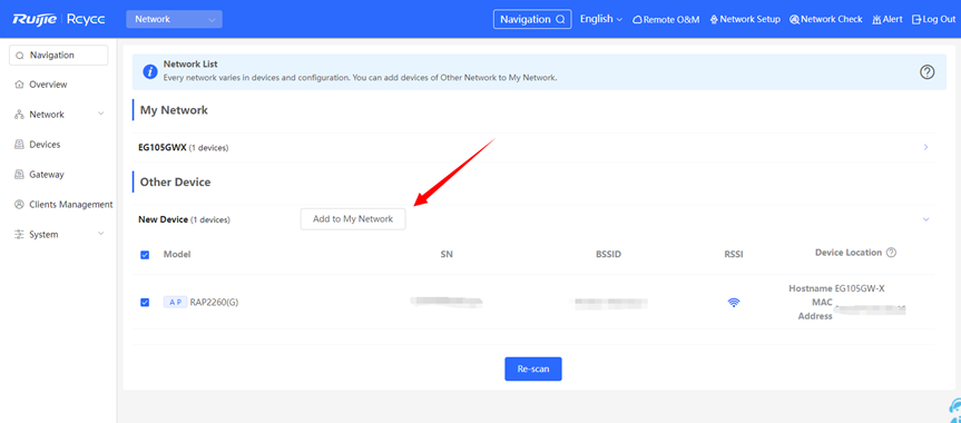

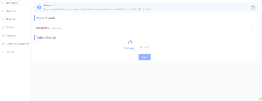

3. In the Eweb interface:
You can follow the following steps to configure mesh
RG-EG105GW
Configuration Router
