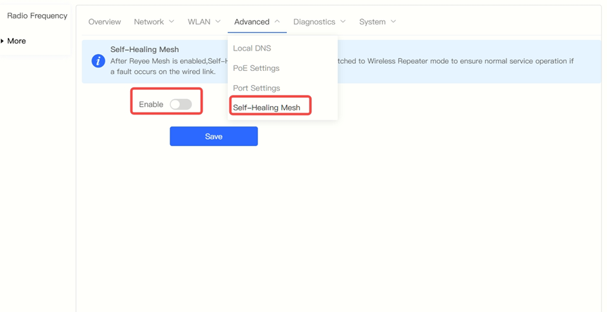

Note: After Reyee Mesh is enabled, Self-Healing Mesh is automatically switched to Wireless Repeater mode to ensure normal service operation if a fault occurs on the wired link.\

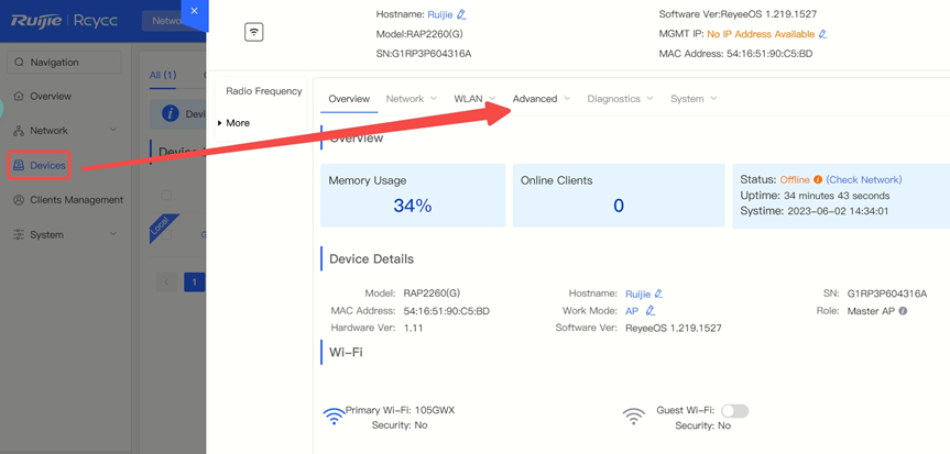

You can find the Self-Healing function on the web interface:
RG-RAP6262(G)
Configuration Wireless
