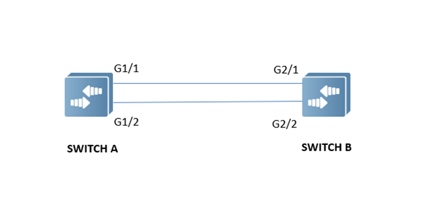

Topology:
Requirements
Add G1/1 and G1/2 to the aggregation port for switch A. Add G2/1 and G2/2 to the aggregation port for switch B. Then configure them to static LACP

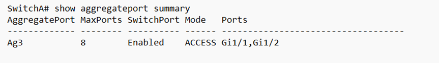

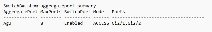

Verification:
SwitchA# show aggregateport summary
SwitchB# show aggregateport summary
