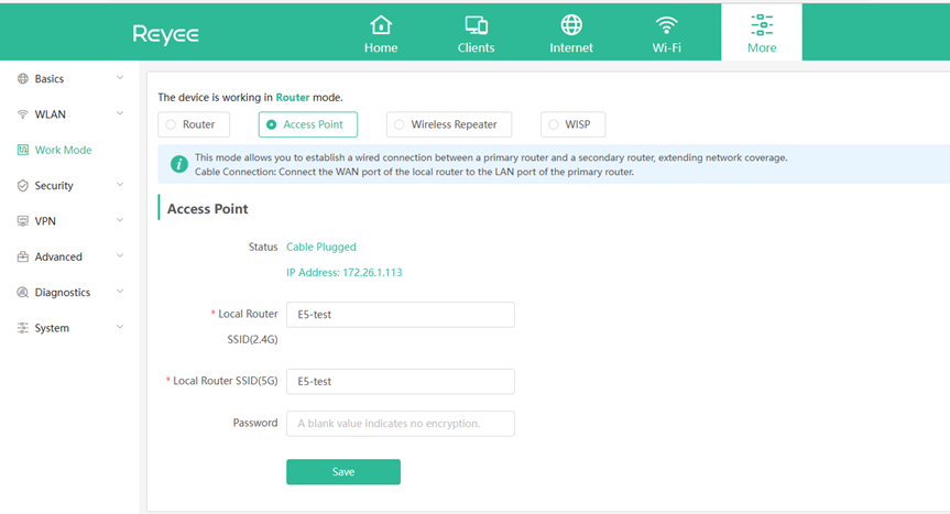

The wired repeater mode: relies on an Ethernet cable to provide reliable transmission over a more stable Wi-Fi network with less interference. You are advised to use the wired repeater mode. Ensure that the primary router can access the Internet with the DHCP server enabled. Otherwise, the configuration will fail.
the Access Point refers to the wired repeater mode
Click [More] --> [Work Mode]--> [Access Point]
Notice: Make sure device has plugged into the primary router

Should the Primary router be set to router mode? then the wired repeater router be set to access point?
0 2024-7-13 09:06:39 View all replies
Glemor Joaquin replied at 2024-7-13 08:49
Should the Primary router be set to router mode? then the wired repeater router be set to access poi ...
Hi, Glemor Joaquin
Yes, the primary router should be set to Router mode.
