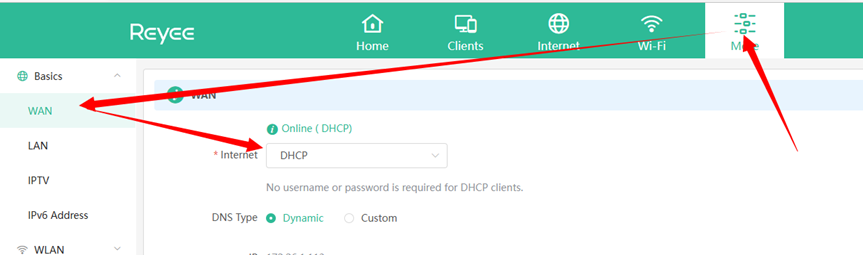

1. Check how the device obtains the ip address, DHCP/Static ip address/PPPoE

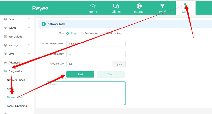

2. ping 8.8.8.8. See if the device can build a connection with the network. If the device can not ping 8.8.8.8, follow the next step
Chick [More] --> [Diagnostics]--> [Networks Tools]

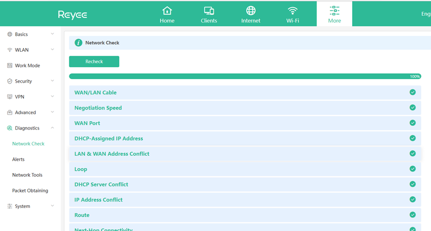

3. Check the network status

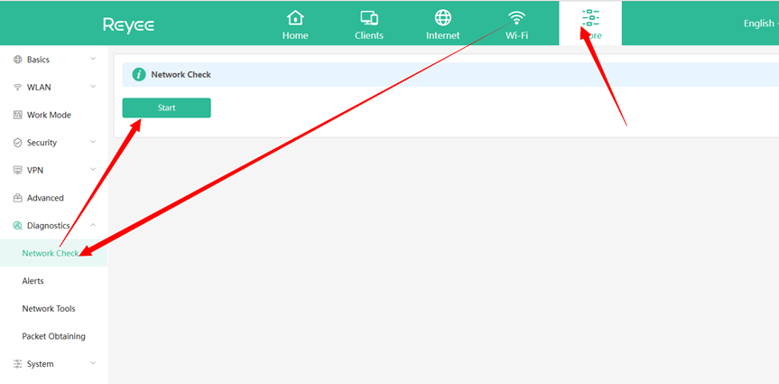

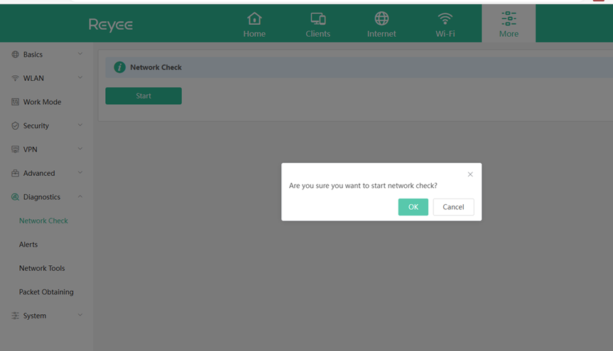

Click [More] --> [Diagnostics]--> [Network Check]-->[Start]
4. After enabling Network Check, you can see which part has the issue.
