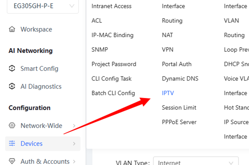

Choose Configuration ---> [Devices] ---> [Gateway] ---> [IPTV] ---> [IPTV/VLAN].

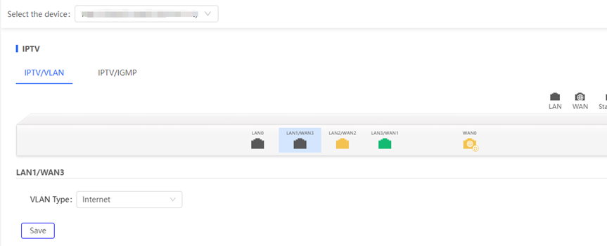

(1) Select the port for carrying the IPTV service on the device.
(2) Set VLAN Type to IPTV.
(3) Enter the VLAN ID provided by the ISP.
(4) Click Save.
Notice: Enabling this function may lead to network disconnection. Exercise caution when performing this operation.
