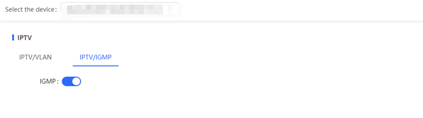

How to configure the IPTV Service of the IGMP Type
4466 0 2023-8-18 17:20:22
Click-->[Configuration]---> [Devices]--->[Gateway]---> [IPTV]---> [IPTV/IGMP].
The IGMP type is applicable to the ISP FPT. After you enable the IPTV connection, connect the IPTV set top box to any LAN port on the router.
