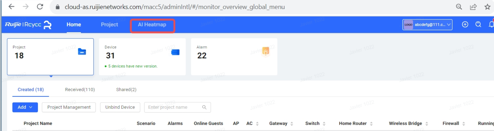

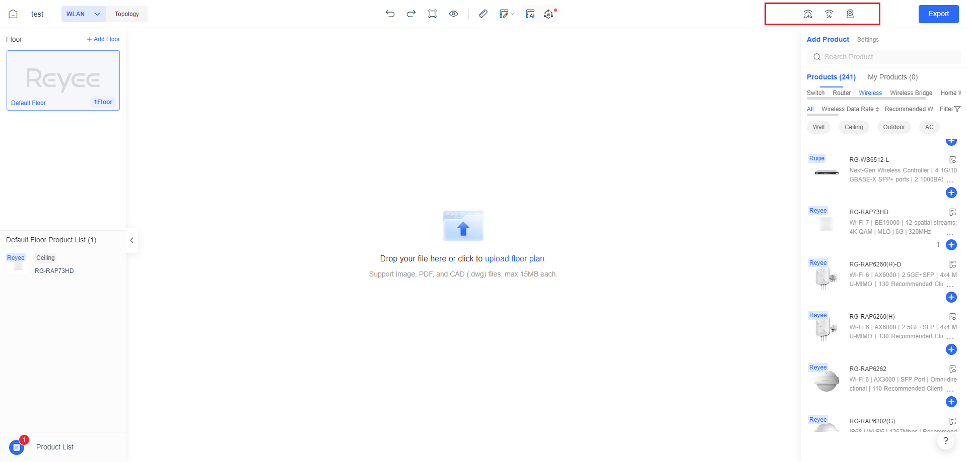

0 2023-8-23 08:26:10 View all replies
Dear:
You can do it through ruijie reyee app, as in the following video: https://www.youtube.com/watch?v=eSyrUEM6j6k
You can also click on AI heatmap on ruijie cloud using a browser:
you can also check the video: https://www.youtube.com/watch?v=zXQDqQ6OqI4
