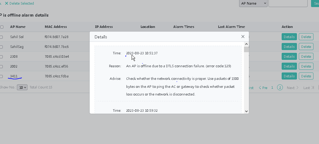

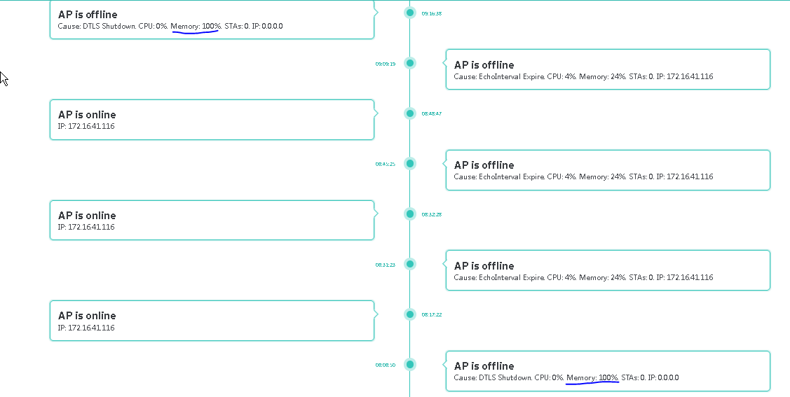

First of all hello everyone,
There are a total of 114 APs in the business, 2 AP's started to go offline in 2 weeks.
When i looked at the log records, the memory was %100 and went offline.
It was working normally for about 4-5 months but 2 weeks ago these problems started.
Have you encountered such a problem before ?
Many thanks in advance for your help
AP-820-L(V3)

1) Confirm that the AP software version of these faults is consistent with the AC version
2) Check AClicense enough
3) see if there are duplicate AP names

I Checked all of them, it's okay, I'm sharing the error details.
0 2023-8-24 11:24:18 View all replies
Berka Belgic replied at 2023-8-23 19:37
Can you traceroute the AC and gateway address? And if in your convinience, plz capture packets when you ping them and send email to me: yangyue1@ruijie.com.cn
