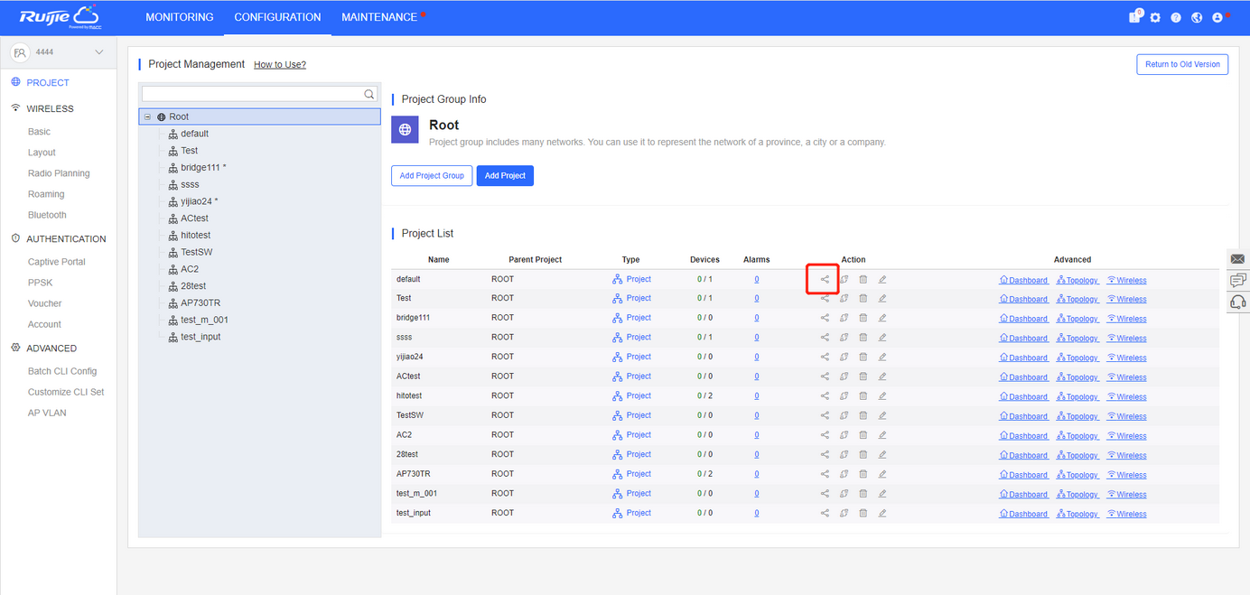

Please help confirm whether your SSID includes the special character: "$", if yes, please help remove it then try again. If the problem still exists, please help share with me your network to my email to further check this issue: yujiamin1@ruijie.com.cn. Thank you fo r your cooperation.

Thank you for your quick reply. Non of the SSIDs have the $ in them. i will share the network with you via email.
